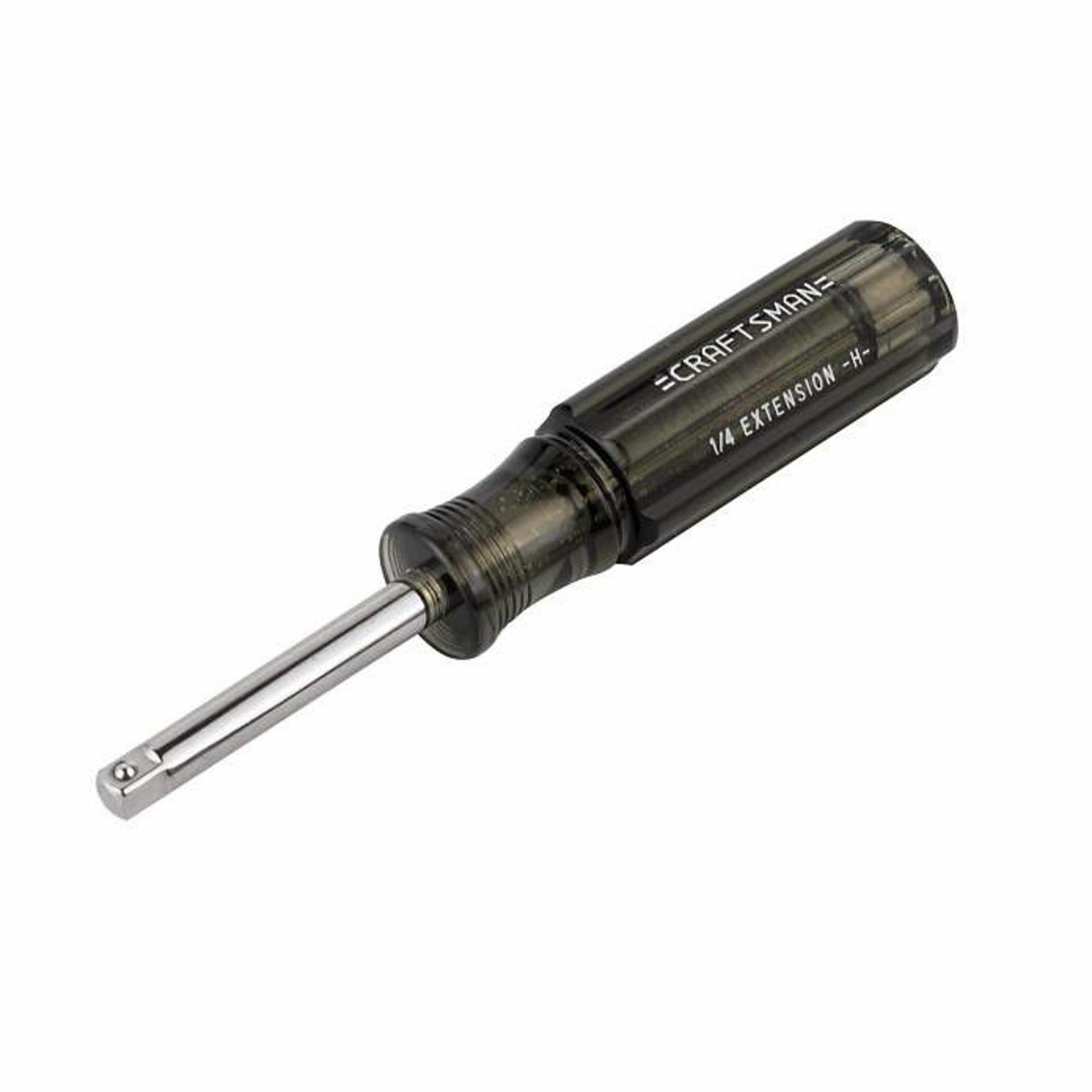

1/4" driver (screwdriver handle that small socket fits on a shaft sticking out of it) https://i.ebayimg.com/images/g/3pkAA...Fi/s-l1600.jpg
