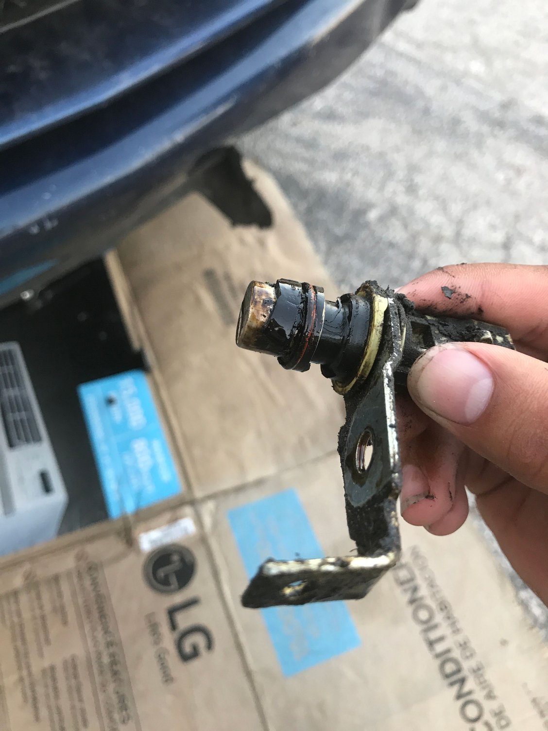

I pulled the sensor out and sure enough it had been rubbing and all of the black plastic stayed inside of hole except a small section that stayed connected to sensor I fished all the plastic out with some needle nose and installed new on with 1 shim (0.5 thickness) I bought a Bosch OBD1150 bidirectional scanner to perform the relearn but it either isn’t capable or I couldn’t find it.... hopefully it was the latter.. although blazer turned on first try seems to be running smoother and driving 10x better I cleared all DTC before installing so on my morning drive to work we will see how she acts and if CEL/SES comes on.
(I attached photo of my scanner also maybe someone is more familiar with it)
This is why you need spacer so it won’t get worn down...
All of the black plastic cover/coating worn down/off

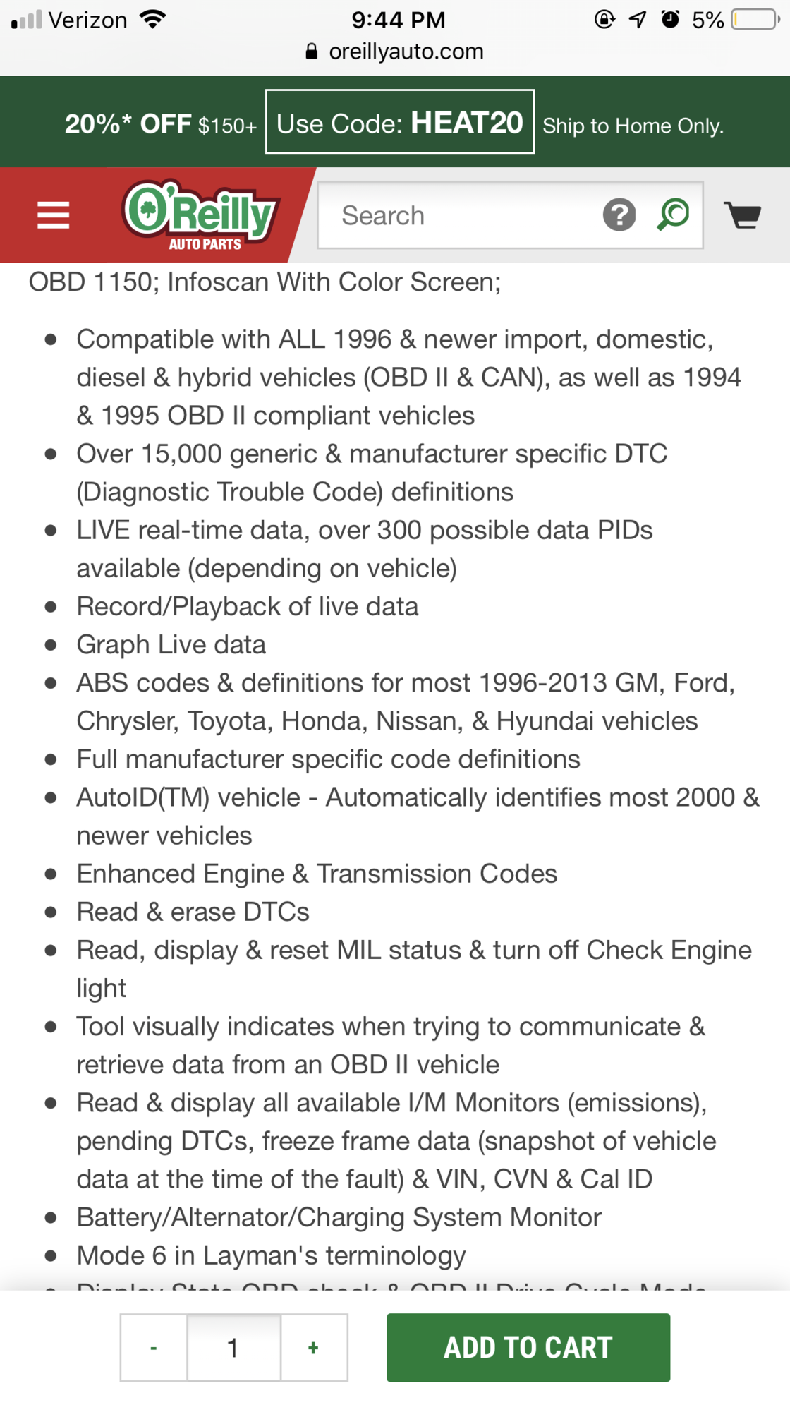

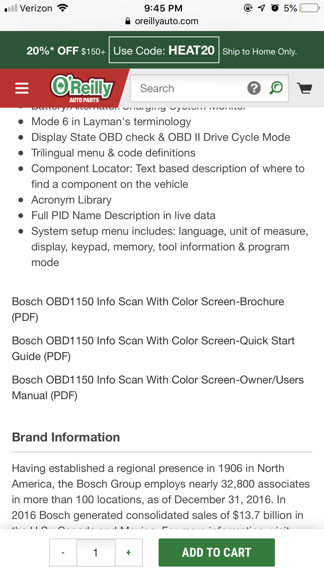

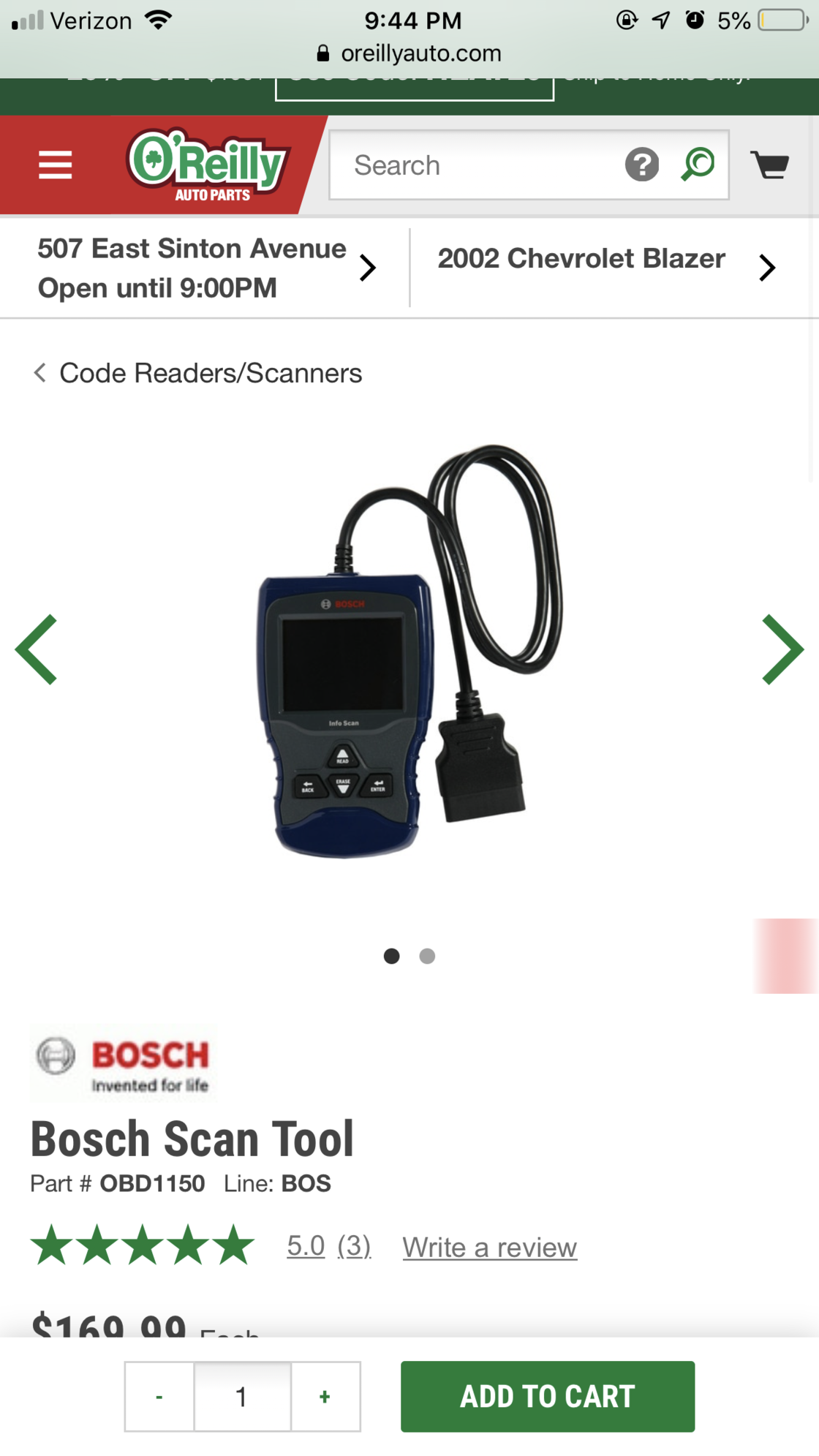

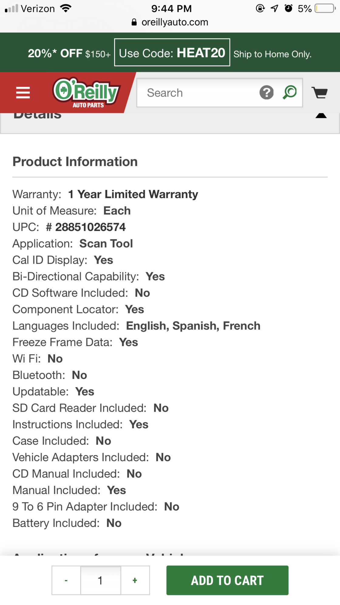

Well not sure if anyone is following but I had contacted Bosch to make sure I wasn’t overlooking it and they informed me the scanner is indeed not bi directional (even though O’Reillys website clearly states it “is”). I called 2 Chevy dealers in the area just for a laugh and 1 quoted $225 the other $130. I called one local shop and guy said he could do it for $40 but we have 2 different lunch breaks and he closes at 430 and I get out at 5 (LOL). I did speak to one of my friends (Thursday) that has a Snap-on triton he will be busy till tomorrow (Saturday). Guess I should’ve just waited before buying the Bosch scanner but I figured for the price why not. Patience is a virtue or something like that. Will update y’all when I do happen to get it relearned.
