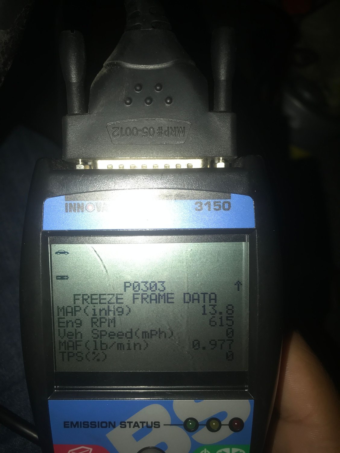

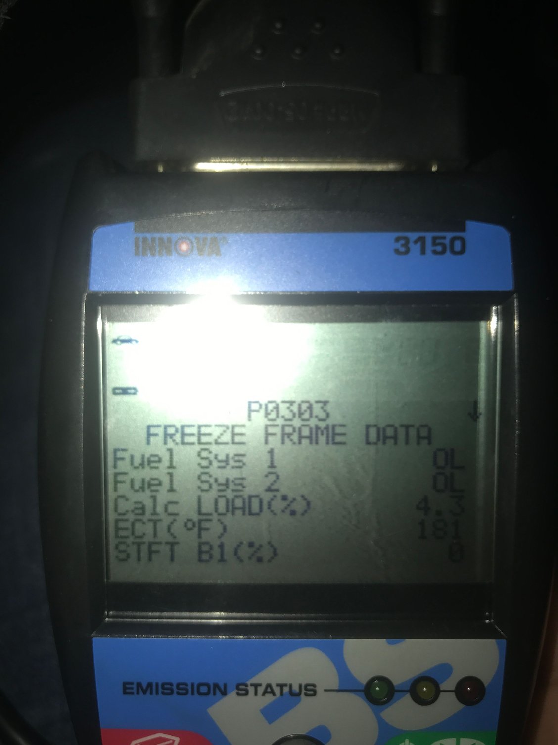

Well my friend ended up getting in contact with me (Friday evening) and we knocked it out. It was literally about 30 seconds hooked up to his Snap-on triton d8 (wish I would’ve filmed it) but anyways so far so good there was immediately a difference in her. Fire up like nothing and ran smooth(took place around 8pm). Well around 11pm on my 15 minute or so ride home my check engine light cane on so I pulled into my drive and scanned it and no more P0335. The only code it has was P0303 twice (misfire cyl 3). I did get a ff not sure if it’ll help anything but will post anyways. I have to leave for work in about 30min so either when I get home or tomorrow I’m going to change out spark plug wire with another plug and see if there’s a difference and change out plug see if there’s a difference then will go from there. I also returned Bosch obd 1150 back to store (even though it’s better than my Innova).
