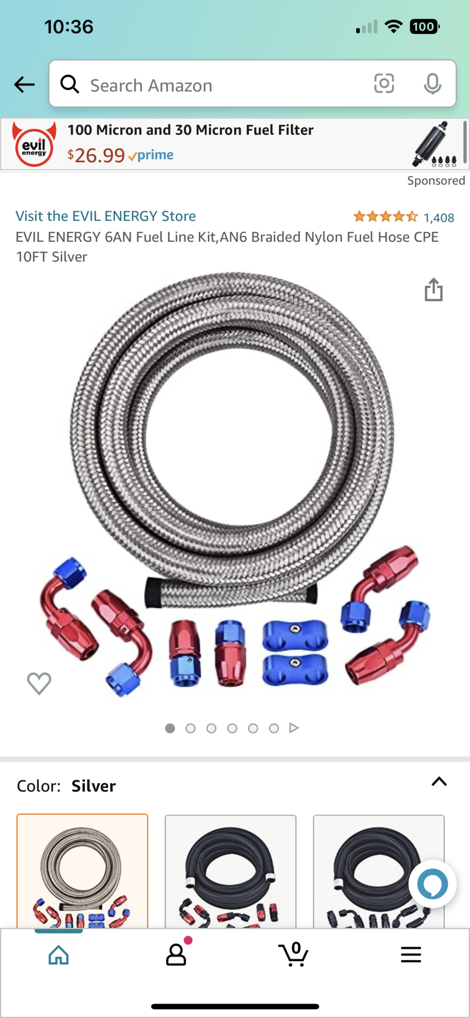

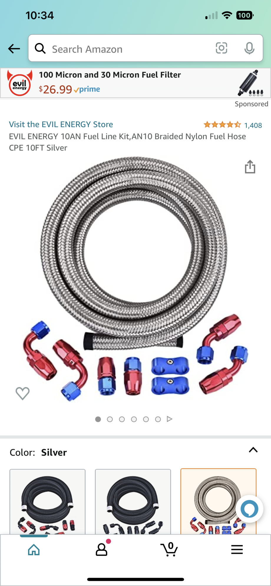

This is what I’ve acquired so far. This Evil Energy pump will work. 75psi of pressure.
I’ll have a 15gal fuel cell I can borrow so that’ll be my fuel tank. Will 10ft of line, both 10A and 6A be enough plus using the OEM lines?
