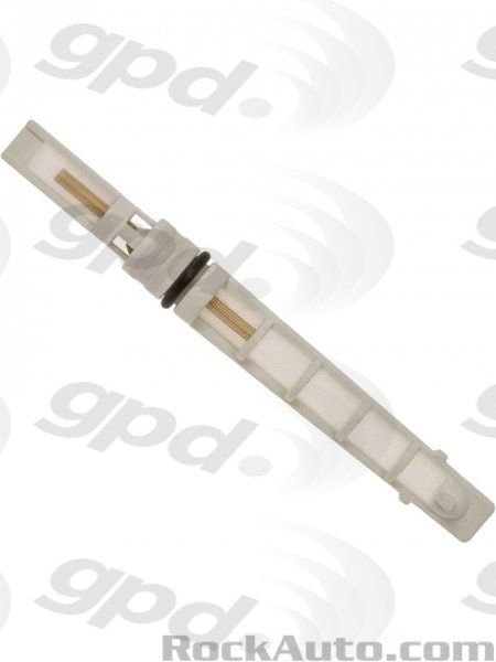

So sorry guys I'm such dope I meant to say evaporator core DUH! This thing.
And here is the filter Im talking about.

No problem but my comment still stands. Replace the orifice tube and accumulator along with the evap core. Carry on soldier.
