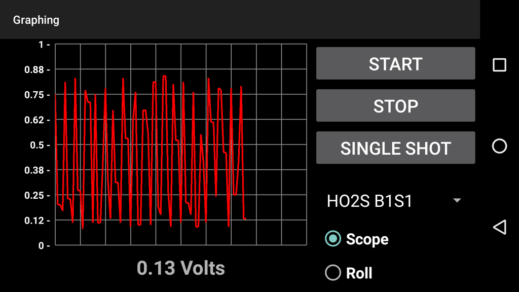

at 2000 rpm O2 sensor cycles back and forth much more rapidly
At Idle
Time scale here is maybe 5-10 seconds for each plot. Note that O2 sensor reading can vary greatly depending on when the reading is taken (you already know this - comment is for other people). O2 sensor is averaging around the 0.45V at both RPMS (as it should if correctly controlling fuel mix).
Seems pretty strange that your STFT stays at zero. Are you sure that Torque is monitoring it correctly?
Also for your post-cat o2 sensor, it sees no real difference with your pre-cat o2 sensor. Is your Cat converter OK? But you would think it would turn on the appropriate code if there was a problem. Should be a much slower cycle than the pre-cat O2 sensor (at >2000 rpm) if converter is OK
