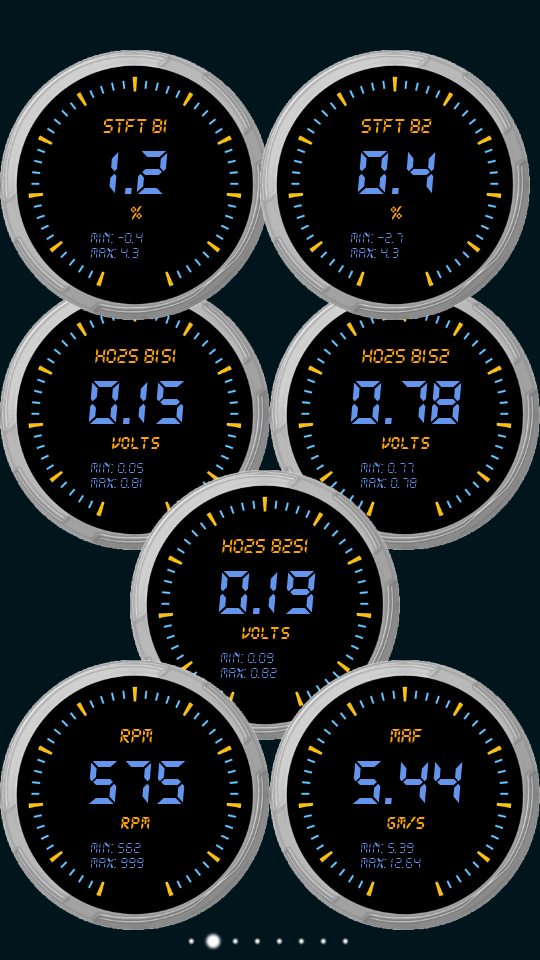

I'm not sure of anything anymore. That screen shot was with the car at idle. I've seen the same type of data for the ST trims at idle with my corded scanner. I am going to follow up on the IAC as I really think it is involved with the problem in some way. If its internal plunger is stuttering or opening and closing quickly, it cold account for fuel trims bouncing all over the place-- at least I think so. I don't know how quickly the O2 sensors cause the computer to react and then command the fuel injector to add more fuel. And that still doesn't explain why its the LT and not the ST trims that are jumping, but I have n o earthly idea how the ECU is programmed. I suppose a bad ground or wire somewhere could be the culprit. Further down on my list of things to try is running new grounds to the ECU.

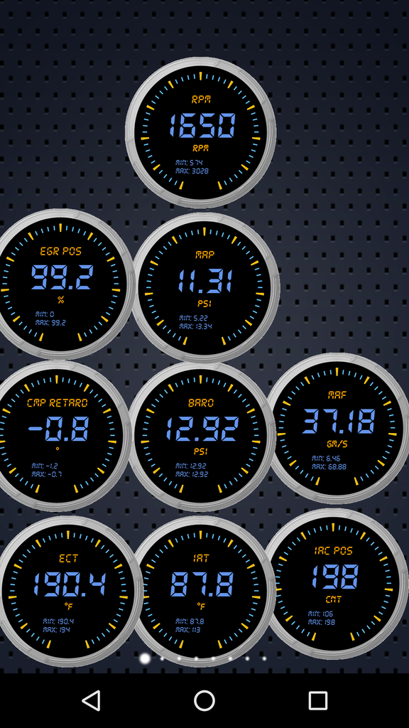

65 mph steady
Idle in drive

cruising steady speed (but MAF is higher than previously so don't know what that was about - maybe before I was decelerating). Note this one has EGR position fully open (99.2%) and IAC position fully retracted (198 counts)

I really wonder if Torque is monitoring things right. Even the famous Torque is not infallable!! You should be able to get Car Gauge Pro to agree with Torque for the Generic OBD2 PIDS such as O2 sensor, STFT, & LTFT.
Once you get significantly above idle, the IAC should retract fully as shown in the screen cap right above this message. Then catch and control the idle speed as it comes back to idle. Mine was max 198 counts - min 106 counts (as shown in the gauge). that's all it really does.

The pre-cat vs post cat O2 sensor thing is only tested at >2000rpm so nothing to be said for being the same at idle.
the time frame for PCM to adjust to O2 sensor readings has to be pretty short or you would set code for O2 sensor being rich or lean. I believe PO171 allows only 120 seconds total for PCM to get fuel mix under control before setting the code. Response time has to be much less than that.

I was right about the STFT. It does cycle up and down with the O2 sensor, but doesn't seem to do it at idle. This is at 2000rpm in park from tonight. I saw it cycle from about -5 to + 3. So Fuel trim response time seems very fast
