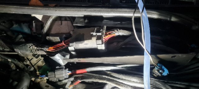

I just bought a Blazer 97 which is not starting only cranking.
In the dash there is no SES or Check Gages coming up on ignition. Also there is no 12V at the fuel pump and the fuel and oil pressure gauges are maxed out.
Is it right that there is only one fuse box on the driver side in the Dashboard? I looked everywhere to find the fuel pump relay but didn't managed it.
The idea it could be the PCM is that the guy from which I bought the Blazer gave wrong start up to the battery and crossed the poles.
Hope someone has an idea on that.

found it:
it was disconnected.and so the PCM got no power.
