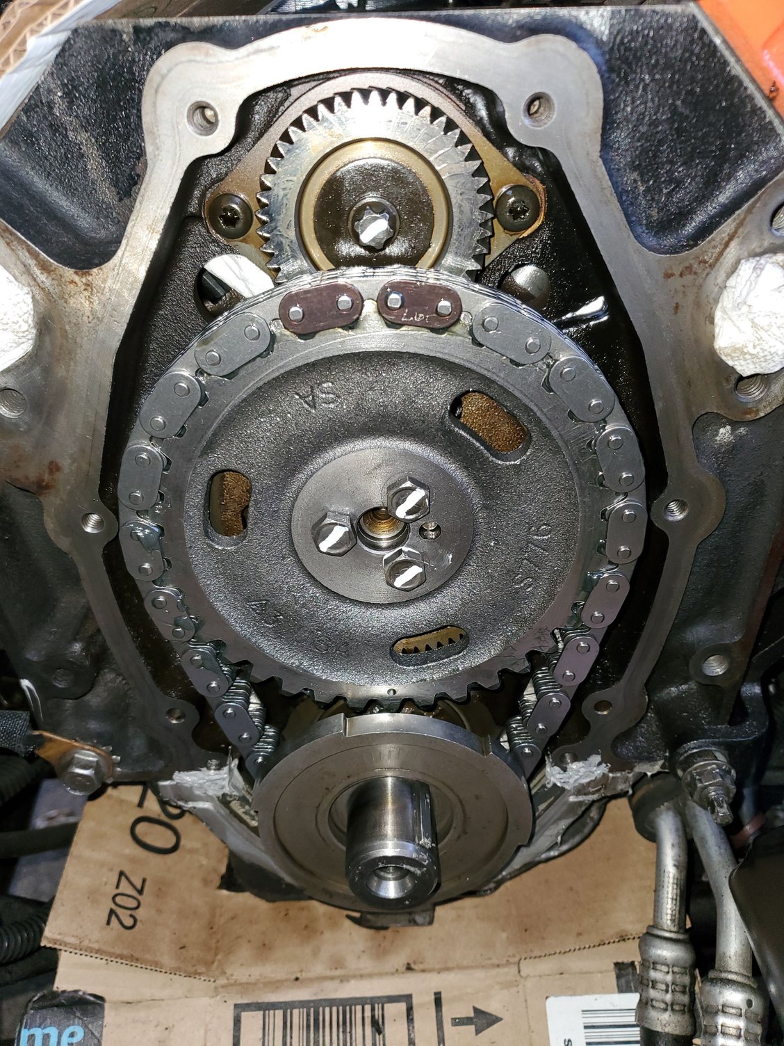

Here's a list of work done/things replaced:
- All upper engine gaskets (head gaskets, upper intake, plenum, valve covers, etc)
- exhaust manifolds and gaskets on the cylinders and to the Y-pipe.
- EGR line from driver manifold to intake manifold
- Push rods
- lifters and lifter guides
- Rockers
- Valves, valve springs, valve spring retainers, valve stem seals (valves were lapped, cleaned and leak tested)
- Knock sensor
- cooling temp sensor (on driver side cylinder head)
- coolant temp sensor (on intake manifold by thermostat)
- Cooling system flushed and drained while the Blazer was running PRIOR to all this work being done.
- radiator cap
- crankshaft position sensor
- timing chain and sprockets
- timing cover
- harmonic balancer
- ignition coil
- ignition control module
- spark plugs and wires
- thermostat
- throttle position sensor
- battery
- battery cables
- ground points cleaned and are all in place
- alternator
- clutch pedal position sensor
- instrument cluster wiring board (the floppy thin wiring board on the back of the instrument cluster. I just swapped the old one with a donor one. The thin wiring on the old one was damaged.)
- cleaned MAF and intake air temp sensors
__________________________________________________ __________________________________________________ __________________________________________________ __________________________________________________ ___________
Fuses and relays checked and are all working.
The timing is correct. I checked this several times. Engine is top center and distributor lines up where it should within spec.
Bright blue/purple spark from all spark plugs and ignition coil.
Fuel pressure tested from the rail with gauge. Fuel pump is OEM and less than a year old. Turns on and off so the relay and pump are good. Fuel filter was replaced a little over a year ago. Fuel has been sitting in the tank since August 7th, but it was new fuel since I also filled the tank that same day. Fuel leak down test read 55psi after 10 minutes.
Spider injector is new and less than a few years old. Each injector was multimeter tested reading from between 12.2-12.9ohms.
I made sure all hoses and passages were cleaned and open before installing them.
All electrical connectors have 12v power and ground, and again all grounding points in the engine bay were removed and cleaned.
Starter motor is a little over a year old, is strong and it cranks the motor.
I'm sure I covered everything that needed to be covered with a "crank no start" issue, but any help with anything I could've missed would be appreciated. Although I probably won't be able to do anything without "professional" help.

I'll check again but I'm certain the distributor lined up where it's supposed to be. When I did the timing chain and sprockets I made 100% sure they were in line with eachother before putting the timing cover on.
I inspected the camshaft with an inspection camera while I had everything apart and the surfaces and back gear teeth where it connects to the distributor were fine. Both cam, balance and crank shaft all turned smoothly when I had everything apart.

I redid the distributor and made sure it was on the compression stroke by listening to air coming out of cylinder #1. Reinstalled distributer and it lines up.
I think I had the crank rotated opposite of what it should have been. I rotated the motor and lined up the timing marks on the harmonic balancer to the timing cover before I put the distributor in the first time without checking whether or not it was on compression. Maybe I am that dumb. We shall see.
