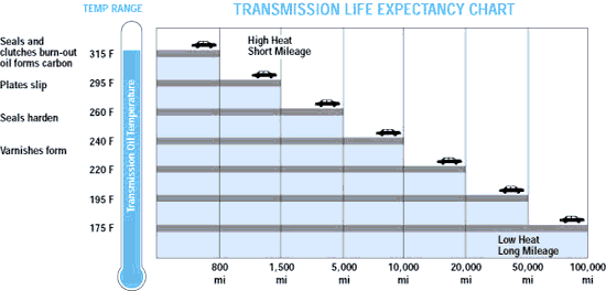

Transmission: needs to have fluid, (DexronVI) filter & gasket replaced every 36k miles. When you drop the pan, about half of the fluid remains in the transmission, that's why the low change interval is necessary. Flushing the transmission is not recommended.
When transmission fluid temperature consistently exceeds ~200F, it will destroy the trans rapidly. If you tow ANYTHING, it needs a cooler installed. Imperial 243012 fits perfectly, with minimal mounting bracket fabrication. If you use that cooler, and totally bypass the OEM cooler in the radiator, it will maintain transmission fluid temperature ~60F above ambient temperature.
These things alone, will improve transmission performance and longevity.
