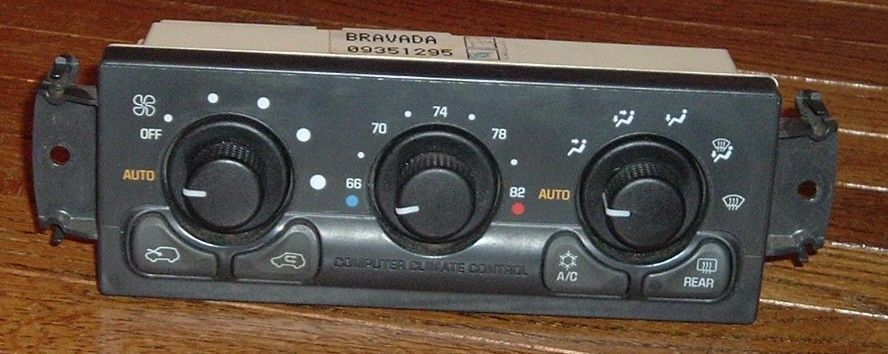

Does the vehicle have manual HVAC:
Or does it have Automatic Climate Control:
Attached Thumbnails 1999 Blazer Help Needed-98-01climatecontrol_zps67799254.jpg
I have the top one the HVAC
And thanks for the responses, I will start looking at those threads right now
Attached Thumbnails 1999 Blazer Help Needed-manualhvaccontrol_zpsa9241ad9.jpg
