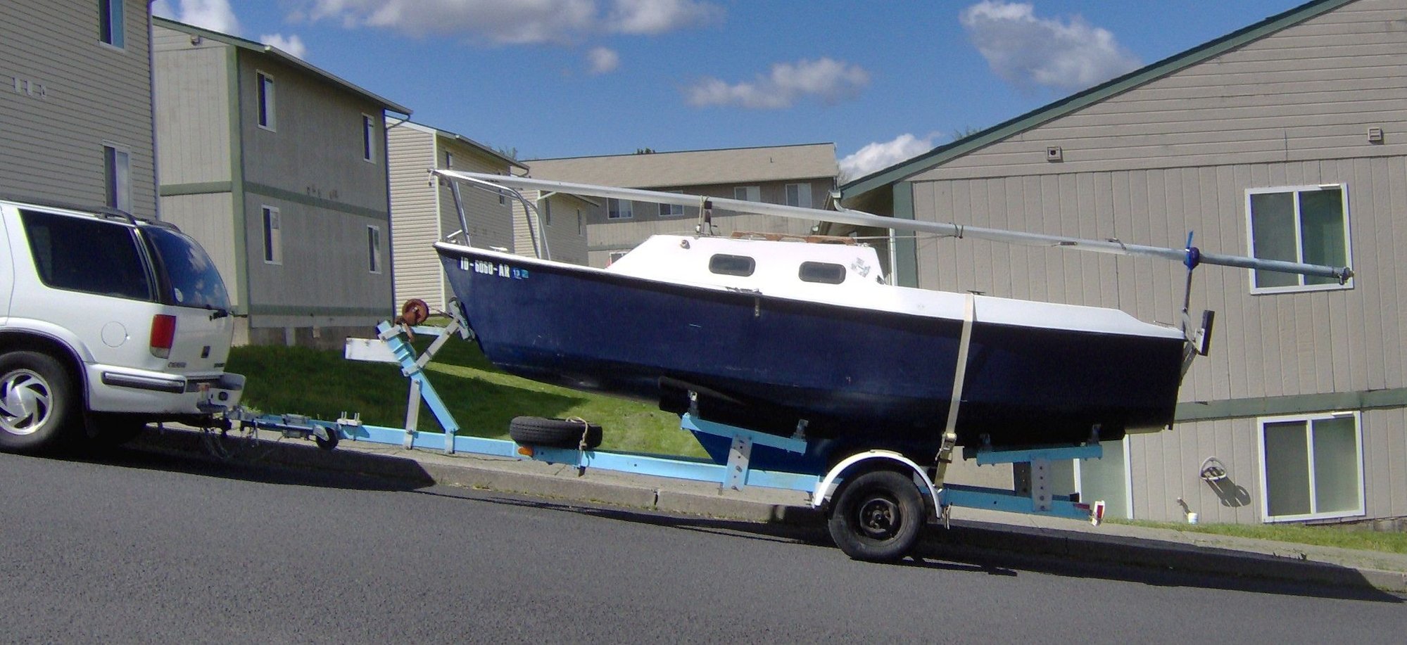

Thanks. Having grown up around hills (near Seattle) and often launching my boat in the summer, my parking brake is very important to me. LOL
I'm guessing don't live where it is very hilly.
Here is a picture of me testing my barking brake. When this picture was taken, It was being held in place by only the parking brake.

I think I recognize those hills, I was in Port Orchard visiting some car friends a few years ago. The only hills in Houston are AKA highway overpasses.

I'm in North Idaho but the west side of WA will also be just a tad hillier than Houston.
