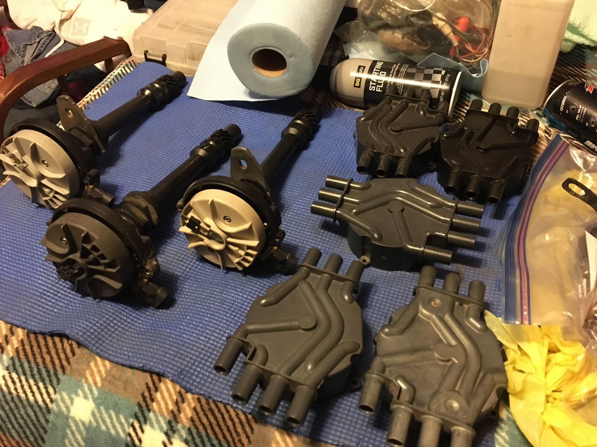

I have tried getting my 2000 blazer Ls 4x4 started for two weeks now, I took out the old Distributor bc I was fixing all issues and trying to have it show “0” when scanned, I got to the point where it would show random misfire every so often not blinking the CEL, so I checked Distributer- melted rotor, got a new complete distributor that has not been used from my grandfather that had it for a 98 that was given to my cousin that he never installed, I dropped it in the same way the old one was (first time messing with a distributor at all & I did not mark anything at all) :/ ... well it started up... I drove to my buddys bc I always test drive close to home before going out with it. We notice when I was showing him the cold air intake I just got that the distributor was LOOSE .. I tightened the hold down clamp by hand then with a wrench that wasn’t an exact fit bc none I had would fit , well I think I know how to get to tdc on compression stroke but Iv read all over that the rotor must point to #1 cylinder AND then also that it must point to the 6 on the distributor housing... which one is correct if it’s installed properly?! Please help my blazer is my baby even my wife is jealous but now we’re both torn bc our noble steed is not running:/.
- if someone could tell me they’re exact story detailing everything when they successfully installed a EDI distributor on a blazer I would forever be in your debt!
- I have just hit 100,000 miles if anyone asks, I no longer have a code reader, no shop, pretty much broke , AND I have altogether three distributors, two new rotors, like 4good caps.... kinda got prepared bc I’m a junkyard rat lol. PLEASE HELP

so i got my blazer started , and drove it home to so itd at least be here, but it’s misfiring, backfiring , the rotor on the distributer is new and the distributor itself is nearly new,the caps good i guess...i have 5caps 2new rotors, 3distributors.. is it possible to havd not gotten all the way to proper TDC or be a tooth off or something? i check my plug wires theyre wwhere they should be..should i mark this distributor & try one i have thats unused? i tested a distributor i pulled out of a zr2 s10 that had a new rotor an cap bc the gear didn’t look eat up whatsoever...

If you examine the distr and its gear and end play and all looks well, thats unlikely your problem. The cam sensor, its connector or the wiring could be bad. Looking at CMP retard with a scanner can help you with that
Check the distr for carbon traces indicating a large timing error.
Start the truck in the dark and mist around with water looking for arcing.
Check the quality of the spark at a plug end - 1" of strong blue spark
You could have jumped a timing gear tooth or your harmonic balancer may have shifted that why I recommend confirming #1 tdc in the cylinder but you can compare. Again CMP retard can help here
Use the last known good distr and cam sensor, go over the wiring, distr cap, wires and reset the distr to tdc. Scan for codes and then look at live data while running, I can give you guidance here. A simple test would be to shift the distr one tooth each way and start it up to see if it gets better.
