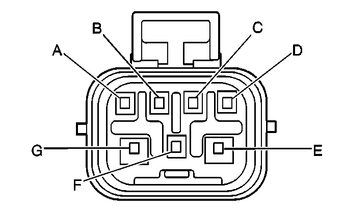

Had a request about the wiring details on a manual swap so I figured I'd post it up here in case anyone else is interested. I can get long winded in my efforts to be clear so bear with me...
To get basic starting and reverse lights you need to make use of the 7 pin connector on the PNP/Range module bolted to the gear select input shaft on the LH side of the transmission.
To get the connector off the module, warm it with a heat gun or hairdryer - they use a wax-like glue/sealer to keep them together.
Very quickly:
A (Not Used)
B (LT GRN) Transmission Mounted Neutral Safety Switch Output
C (PNK) Fuse Output - Ignition 1
D (BLK/WHT) Ground
E (PPL)Fuse Output - Crank
F (GRY)Backup Lamp Feed - "Monitored" (whatever that means)
G (PPL/WHT) Starter Relay Feed - Coil
Important ones for starting are 'E' and 'G' - when the key is turned to 'start' or 'crank', 12V is supplied to 'E' - you need to take that and run it through your clutch switch so that the 12V comes back out with the clutch pressed in. Then take that 12V and feed it back into 'G' - this will enable the starter relay.
To get reverse lights, take the 12V power from 'C', run it through the reverse switch in your manual transmission and then back into 'F' - lights should come on when the trans is put in reverse.
Telling the computer you're in drive is a little more interesting. Thats where the second 4 pin connector comes in.
This is a 'digital' connection of sorts and is somewhat cryptically labelled as follows:
A (BLK/WHT) Transmission Position Switch - Bit 1
B (GRY) Transmission Position Switch - Bit 3
C (WHT) Transmission Position Switch - Parity Bit
D (YEL) Transmission Position Switch - Bit 2
These pins are grounded by the PNP/Range module depending on what gear has been selected.
Simple answer to get drive is to ground pins B and D - most easily done by connecting both to pin D of the 7 pin connector above.
To get all(most) positions, a fancy arrangement of relays (or an arduino) would have to be set up to ground the pins based on this table:
Range Pin A Pin D Pin B Pin C
Park GND N/C N/C GND
Reverse GND GND N/C N/C
Neutral N/C GND N/C GND
Drive N/C GND GND N/C
D3 GND GND GND GND
D2 GND N/C GND N/C
D1 N/C N/C GND GND
(Pins are labelled A,D,B,C because i translated from the FSM logic table out to the wires)
Not impossible but if someone REALLY wanted to do this, PM me and I'll have a go at the logic to get Reverse, Neutral, and Drive inputs to PCM
I also did once see a setup to make the PCM think an auto was still attached and not throw codes, i think it was on one of the fiero forums - IIRC it mostly involved putting incandescent turn signal/marker lights on the wires that would control the solenoids in the transmission.
The above information was mined out of a FSM for a 2000 Blazer/Jimmy/Etc - it was in my notes for what I'm going to use on my (long coming) swap - Double checked my notes back to the FSM tonight to verify details but do be aware this is technically theory for me right now. Post up results if you try it!
