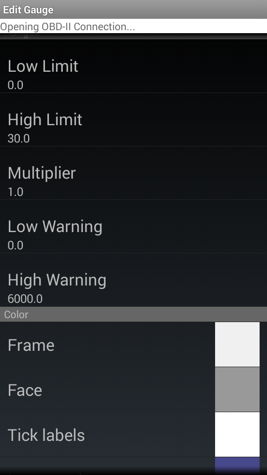

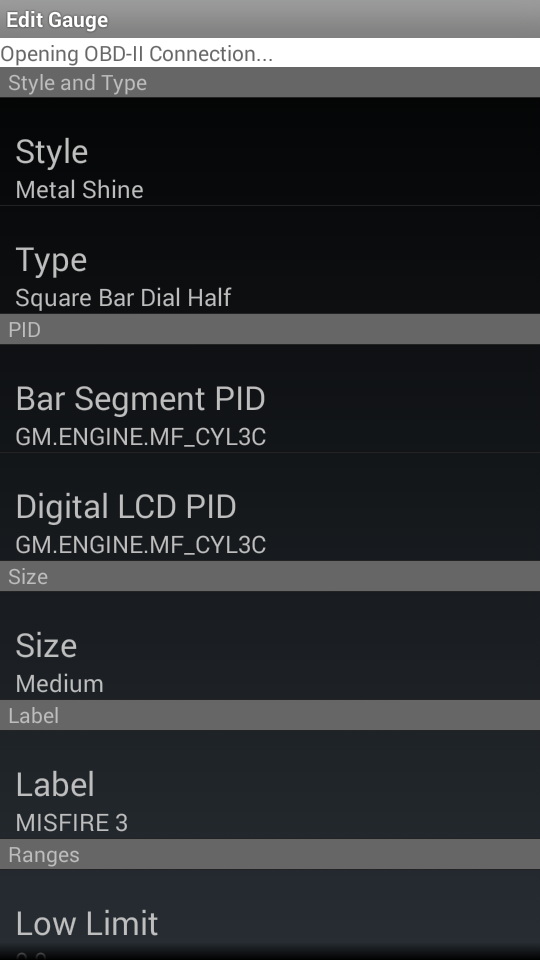

Hey less, seems like my misfire gauges might not be accurate. Would you mind posting the info for those, or rather one. I thought I had them set but they're not registering anything. Wondered if I did them right.
Later
BTW, no hurry on the gauges, hell man its a Holiday!
That's what I was talking about getting to work in Dash Command in another post. When mine does that, I just close the gauge screen and open it back up once or twice until they start to work. I'll post my setup on them later tonight but it's really nothing special.
Let me know if closing the screen and opening it again (repeatedly if necessary) works for you.
Attached Thumbnails 96' Blazer with hesitation and misfires-screenshot_2016-07-04-20-13-32_zpsh2xwgwha.png   96' Blazer with hesitation and misfires-screenshot_2016-07-04-20-13-42_zpsrizyvwir.png
