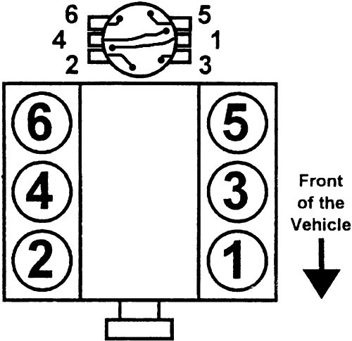

First off.. if you just went to the parts store and said "Gimme cap rotor and wires for a.." then you havent really eliminated those: Here's why.. look close:
See where 1 and 4 are in the cap? AC Delco cap rotor wires, ONLY AC D or NGK double plat or iridium plugs only.
Cheap wires are WELL known to fail right out of box. If they touch each other or been stressed in any way.

Idles great, temp stays below 210 and stays pretty consistant @ about 190-200, acts up weather its cold or hot., been running or not been running. Doesn't seem to be any power loss but does sound like its got a skip to it. Cylinders 1 and 4 were misfiring. Replaced plugs AGAIN and seems to have taken care of it..for now. Only thing not ac delco is the wires. Used bosch because I couldn't wait 2 days for a shipment. Motor shakes pretty good like something is off balance. Recently did belt and all pulleys were free and operational.
