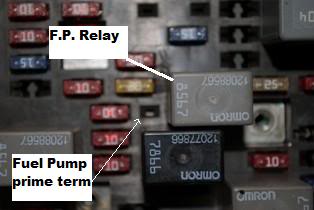

In the underhood fuse panel there is a vacant terminal next to the fuel pump relay. When you apply battery voltage to the terminal, the pump must activate. The circuit runs from the terminal, directly to the fuel pump, through a grey wire. It must show battery voltage at the pump module. The ground for the fuel pump is on the top rear left frame rail, extreme left rear corner of the frame. If that ground fails, the pump will not activate. Post your results and any questions.
