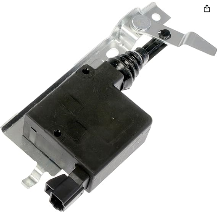

If this is for the rear lift glass that pops the glass open, I had this little plastic arm on the actuator of mine break a month ago. You can buy a 2 pack replacement of these on amazon if it's just this little blue arm:
Amazon Amazon
This is the whole actuator:
Amazon Amazon
The black plastic clip shown here attached to the metal arm (mine was blue) tends to break, which causes the glass to not pop open, but you'll still hear the motor try to pop the window open.
I'm not sure if this is the same for the 2DR, I have a 4dr with the tailgate. I had a hell of a time getting the window open without this, and I busted the interior handle to the tailgate trying to open the glass by actuating the rods in the tailgate..

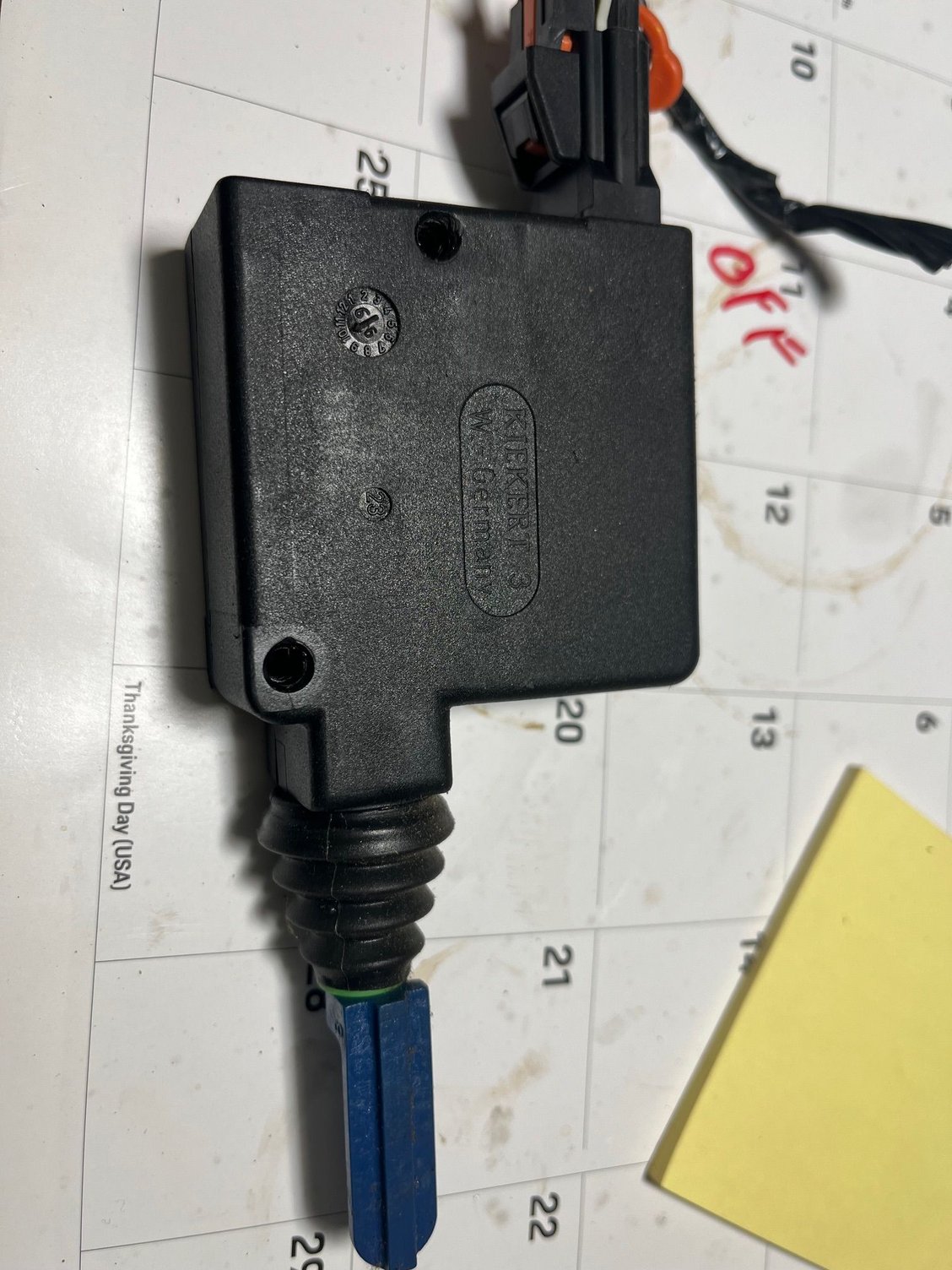

well got the inside panel off,cant be done without some damage...yes it has the blue junk..lol,,going to tear apart my 4 dr doner junk probably the same part...thanks

temporary fix drill hole use wire

no wonder these last so long...made in Germany

Very nice on that wire trick, I wish I would've thought of that!
(Knock on wood) I haven't had to replace any of the door actuators on my blazer and I think you've found out why!

You guys saying this is the piece that breaks? Dorman 42426
Amazon Amazon
Lately about half the time the window won't open and I have to fiddle with the key and button so I best take care of it now?

Usually that is the part that breaks. When it does break you'll hear the actuator/motor running back there when you press the button but nothing happens.
If you don't hear the motor running when you press the button it might not be that. You'll probably have to remove that panel to see what's going on under there.
