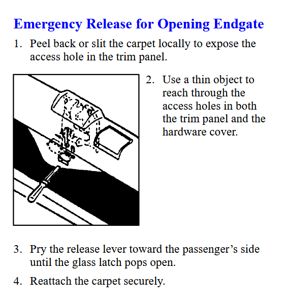

I'd be fine predrilling a hole just in case of a breakdown, where is the place?

Believe it or not, this is the emergency release procedure from the owner's manual on my 02:
I think you might be able to get away with just peeling the carpet back. I unfortunately didn't notice this until now so my panel is busted from ripping and yanking on it to get a screwdriver in there to release it

Nice, TY!
