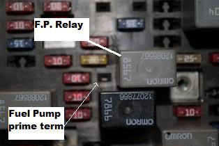

Just for grins, apply battery voltage to the fuel pump prime terminal in the underhood fuse panel. It is located next to the fuel pump relay. This circuit bypasses the ignition switch, Passlock, BCM, & PCM. It goes directly to the fuel pump, and the pump must come on and pressurize the fuel delivery system. While the terminal has voltage applied, attempt to start the engine. Post your results.
EDIT: Back in post #14 I mentioned the BCM disables the fuel injectors... GM has made numerous changes to Passlock and Passkey systems, almost on a yearly basis. After looking over some GM publications, I'm pretty sure on your 99, that when the BCM detects a possible theft situation, it will not allow the PCM to activate the fuel pump. That's the reason for this test.
