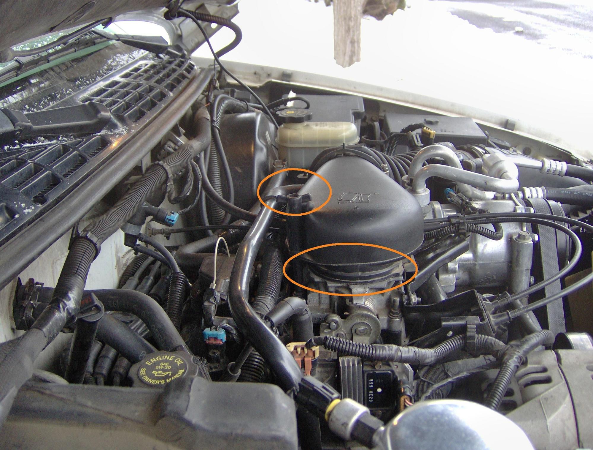

Originally Posted by ouwee
Okay, can you send me a pic of what you are talking about? Thanks Christine!
OK, so what I am talking about definitely falls under the category of "It is so easy to check, I might as well check this just in case it is the problem."
In the pictures below I've circled the places that occurred to me where a large vacuum leak could occur. But as I write this it occurred to me that there could be leaks all along the duct/snorkel. You might want to check the whole length of the the duct/snorkel too.
The way things should look.
Both locations with (exaggerated) gaps.

That's my exact engine! In the top circle, the wingnut is what broke and caused the issue in the first place. The throttle body blew completely off when it happened. I couldn't find another wing nut like that one, so I had to use a regular 9mm nut to tighten down the throttle body (I'm guessing that the lower circle is called the throttle body. Am I correct?) Anyway, I thought the throttle body might be leaking, but when I put my hand around the bottom part of it, I don't feel any suction going on. What do you think?
So to be unambiguous, the throttle body is the metallic thing in the lower half of the lower circled area that has a butter-fly valve in it. The black part that supplies the air from the air filter is the duct (for the lack of a better word).
This duct must be sealed to the top of the throttle body as the sensors the engine computer uses to know how much air is being delivered the engine are between the throttle body and the air filter. If there is a place where extra air is coming into the engine, the engine can run rough or at least inefficiently.
Have you checked the length of the tube that connects to the back side of the duct and goes to the passenger side valve cover to be sure it has no leaks?
As for the wingnut, I would think you could get one at a U-Pull wrecking yard. They might even have them at a parts store or your local GM dealer (if you want to pay more money ).
I am a bit concerned with how the duct was blown off in the first place. In carbureted engines when there is excess fuel delivered and the mechanical timing is off, the gas in the intake manifold can ignite and create a flame that goes up through the carburetor. I'm wondering if something like that happened to you. What prompted you to replace the fuel pump?
