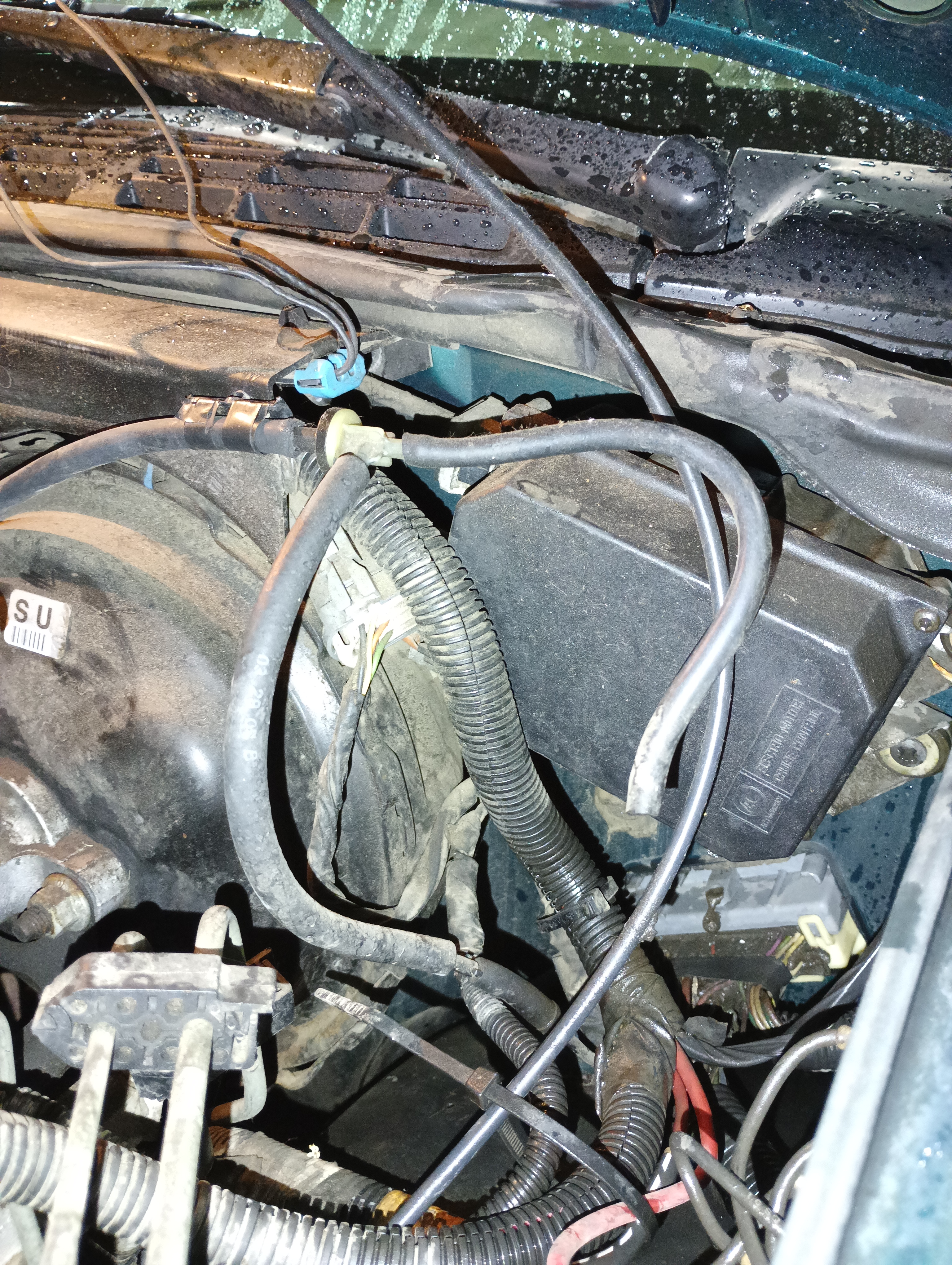

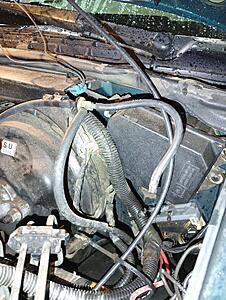

Question
Originally Posted by hans109h
Right in the same area the vac hose that goes to the firewall there is a three way splitter on the lines, there is usually one really short piece of tube that wears out really quick, check it for any cracks. Basically if you touch the line and it instantly turns your hand completely black, it's time to replace the lines.
If this isn't your problem, then you might have to pull the dash and check for vaccuum at the controls.
The small tube you're talking about where does it plug into because that is where mine has seems to be disconnected from the small tube is not connected to anything or is it supposed to be
Attached Thumbnails Airflow control is not working-1731289246428632765642296126772.jpg
Old Nov 11, 2024 | 08:06 AM
hans109h's Avatar
Joined: Dec 2009
Posts: 15
hans109h is on a distinguished road
That's the line that goes to the nipple inside the fender to the rear of the abs module. Slide your hand along the driver's side edge of the engine compartment, you'll find it.
