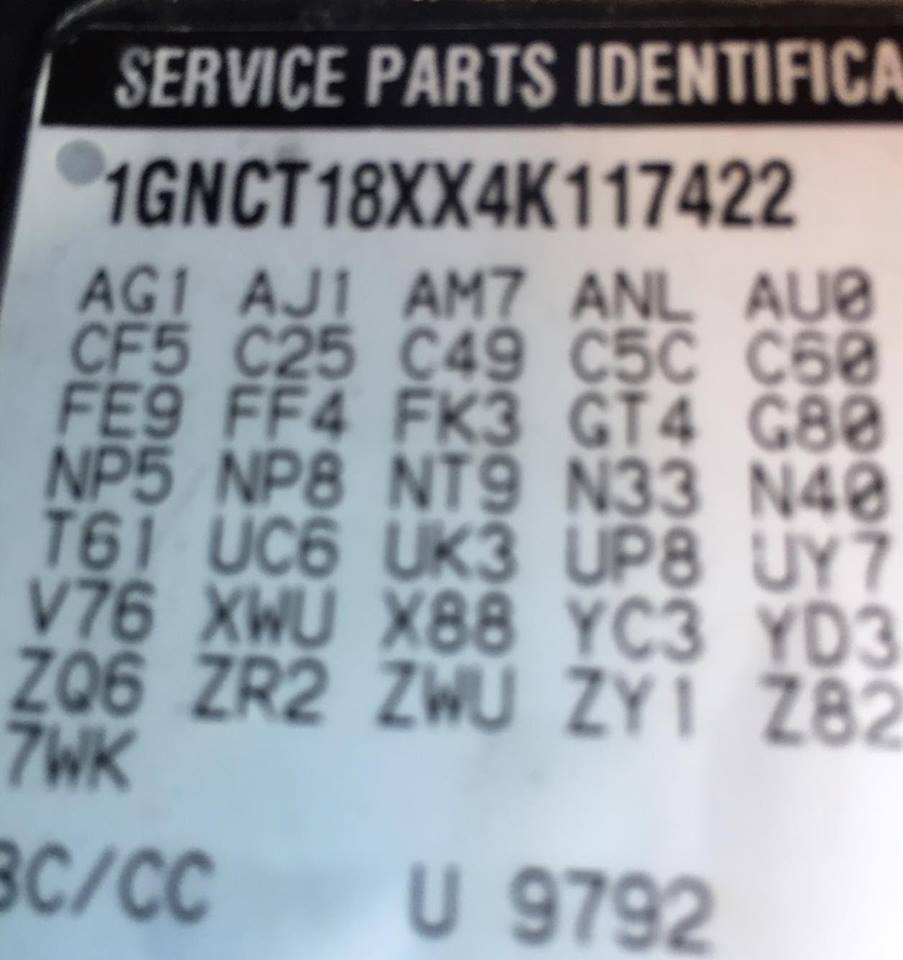

I recently saw an add for a 2001 ZR2 Blazer stating it had the rare "all wheel drive" option. I tried to research it and the only reference I found was that some ZR2 Blazer LT models were given 4 wheel disc brakes if they had the all wheel drive option. I have a 1998 ZR2 Blazer LT with 4 wheel disc brakes. Does anyone know how I can tell if I have that all wheel drive option. This option is over and above the 4 wheel low and 4 wheel hi selections.
here are the codes for my ZR2 2004 Blazer.. I have an NP8 Transfer case
