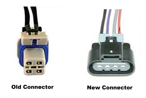

If the valve plate in the regulator were to stick open, pressure at the service port would be extremely low, but there would be some. It would drop off to zero the instant the pump shut off. This would have no affect on pump run time. Extended run time is either sticky contacts in the fuel pump relay, or sticky/shorted contacts in the OPSU.
Check the connector at the fuel pump module. The old style connector was known for overheating and distorting the plastic, causing a poor, and eventually open circuit to the pump motor. Most new pumps come with the new style connector and it needs to be soldered to the vehicle harness, (do not use crimp connectors).
I installed the new connector when I replaced the pump. I also swapped fuel pump relay.
