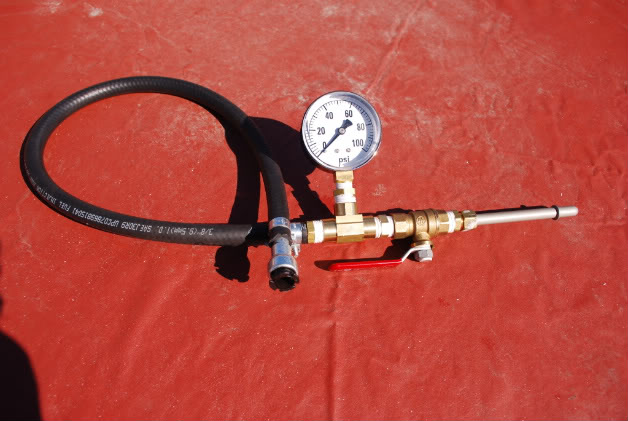

what are you guys building to test the pressure at the filter ? im trying to figure out what i need to test it there instead of the shrader on the rail area.

This is a tool that I made a few years ago. It will work on 1997 & newer 4.3L engines. (1996 & earlier require different connectors.) It connects inline at the fuel filter. It will test regulated fuel pressure and leakdown, (same thing as testing at the service port by the distributor). It will also check fuel pump maximum output pressure and is capable of isolating the fuel pump to check for leakdown in the fuel tank. Total cost... maybe $45, about the cost of a decent pressure tester alone. The brass adapters, ball valve and gauge are available at a home improvement store or a good hardware store in the plumbing department. The quick connect fittings etc are available at most auto parts stores. The rubber line must be "fuel injection rated".
