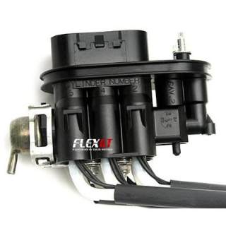

Are you sure you routed the injectors correctly? Two of them cross each other on the driver side. The cylinder numbers are stamped on the side of the injector housing. You can see them in the image below for the passenger , (right) side:

the trouble started when i changed the plugs and wires. im going to try putting the old wires back on tomorrow im so frustrated.
Firing order is correct, no they arent AC delco plugs, they are autolite plugs just like the ones that were in it for the past 80k miles that ran great. yes the injectors were installed correctly, and didnt change a thing.
