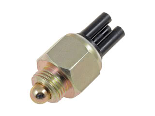

Yup, NV233 is a 2 speed selectable, electric shift case. It does not have "neutral" which makes me think, from your description, that it might be an engine or a clutch/transmission issue. Although, the grinding might be caused by a faulty transfer case vacuum switch:
If it leaks internally, it can cause partial engagement of the right front axle, (usually on acelleration). Simple job to replace it, and the part is under $20.
Is the "Service Engine Soon" light illuminated?
