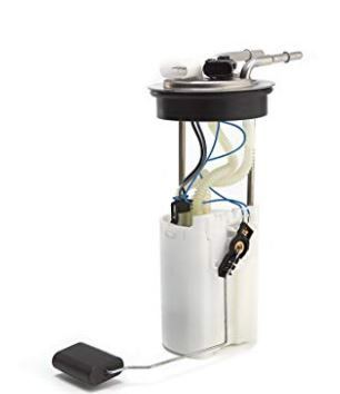

2) I searched around for Delco/Delphi fuel pump, I see the pump motor go for $40-60. Should I get a Kit or the whole assembly? (attached) My fuel gauge a little bouncing but not too bad.

This is the assembly that sell for $100-200

So, every time you do a fuel pump, you should drain the tank. It doesn't take long, and makes your life SO much easier! You need to either remove the pressure fitting at the sending unit, or disconnect the fuel filter. Go to home depot, Lowes, whatever and get a fitting that screws in, with a hose barb on the other. Rina length of fuel line from that to your gas can, and jump the pump off under the hood till she's dry. I've never had a pump die so bad that it wouldn't move fuel. Even if it wouldn't run the car, it should still make a few psi.
I'll never use another Delphi fuel pump in my truck! At least not from advance Auto. Went through three in a year. Get an ac Delco from rock auto. Around $60. I went cheap on the sending unit. If your gas guage works, might not worry about it. It'll bounce no matter what, it seems to be normal.
Now, on the first sending unit I bought, one of the wire connectors under the hood had started melting! Truck ran until it got hot, and lost connection. Wait for it to cool off, and would run again. I've got a pic of it somewhere. I rigged it up and drove with it for a few years, before I finally replaced it.
I've never had an issue with aftermarket fuel filters. Matters more if you change them semi regularly. Always a new filter and strainer when you do a pump.
With a 95 Vin W, you'll want the second pic, where it's just the motor. On our trucks, the motor and sending unit are able to he separated. Kinda nice, when the pump goes its only $60, vs $200.
