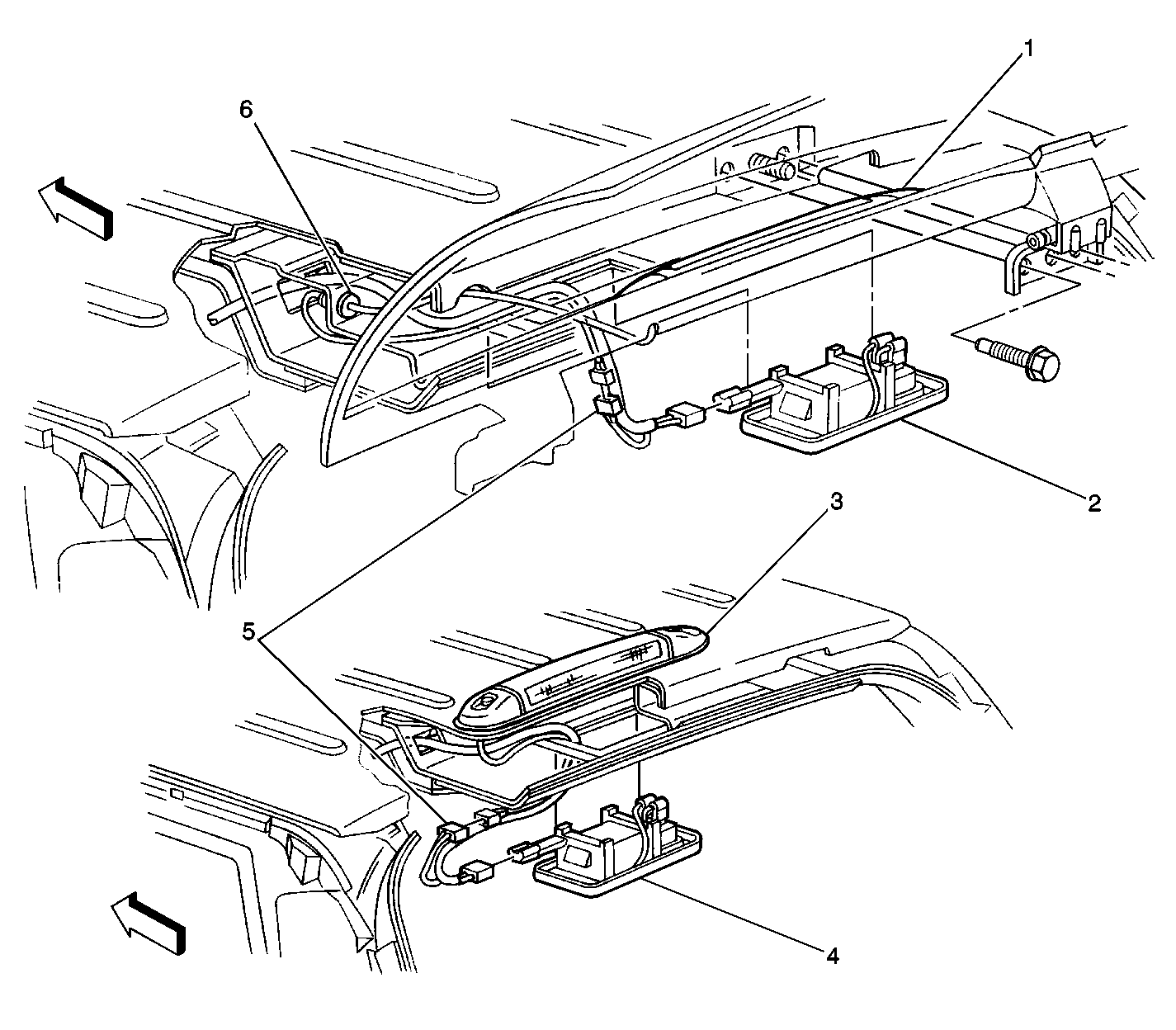

My high brakelight wont work. The other brakelights work fine. Is there any tips on how to find an electric diagram for the 98 blazer on the web? I have looked here in the forum but cant seem to find any diagrams?

couldn't put my hands on a wiring diagram - this is the best I can do for you
