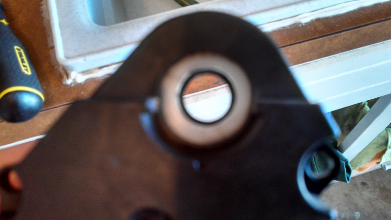

I just became a member due to the great information I have found in helping me with repairs to my 98 Blazer. Recently I have been searching for the reason why my A/C is only blowing hot air, after reading many post I decided to look at the blend door actuator. Found the gear was broke, I have now gone to 3 different auto parts stores and the GMC dealership and can not find one that matches to mine.
The actuator was found behind the glove box, like stated in many posts on this forum. My actuator is matches all the other actuators mounting hole locations, but where it mounts onto the blend door shaft is the first problem. All the actuators I have looked at have a bushing that protrudes outside of the housing. One opening a small I.D. bore the other almost "T" shaped. Mine has a straight hole, guessing around 3/4" or so, and smooth. That is slid over the blend door shaft which is knurled or spline. The second issue is my plug in for my actuator has 6 pins and all other that I have looked at seem to have less and the missing pin is in different spots depending on which actuator I looked at.
I'm to the end of the line no one else seems to be able to help me, any information anyone has on what I should be looking for or doing different please let me know. I have a 4 year old that hates the windows down on the 20min drive home and its really warm out now.

Do you have manual climate controls or automatic? I believe the actuator may be different depending on which system you have.

I have a 98 chevy blazer LS series, looks like my wiring harness for the actuator has only three wires going into the plug. My heat/ac works off of three turn *****, one for temp another for fan speed and then for the third for ac and vent selection. I've looked at both manual and automatic style. Neither had the hole size that would fit the blend door shaft, unless that bushing is removable? Any thoughts

I just happen to have a blend door actuator sitting here next to my chair. I took a look at it and I don't believe the bushing is removable.
You definitely have manual controls. The actuator should have four pins and there should be four wires going to the plug. Your actuator doesn't match what I know about the actuators that I've seen. It's very strange that it has six pins instead of four.
Can you check the RPO Code for your climate control system? It should be on the RPO Code list in the glove box. In 1998 the code for manual controls should have been C60. The code for automatic controls should have been C68. Let us know which code you have. That may give us a clue as to what's going on here.

According to the RPO code you should have manual climate controls with a four-pin actuator. I'm not familiar with the actuator in the picture you posted. I've never seen one like that before. I don't have any other specific ideas.
Have you tried looking for a part number and searching for it on RockAuto.com?
