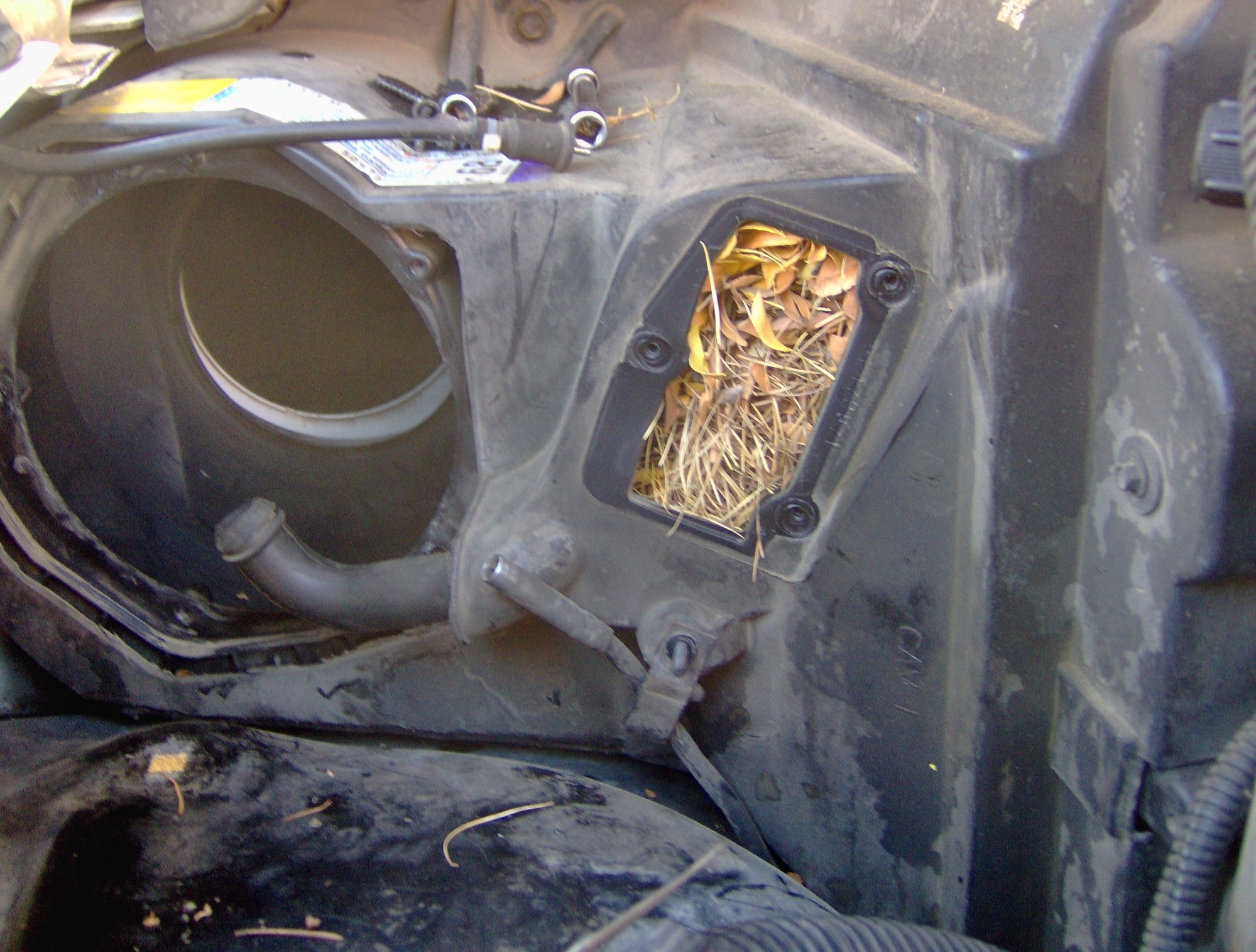

If you have the computer climate control system, then you must have a second gen Blazer. You also won't have a resistor network for the blower motor but a solid-state control module.
Perhaps it has failed or cannot function properly. When I had to replace my blower motor for making noise, I found that the space where the module is placed was packed with leaves. I'm sure it did not help its function. This might be an easy check to do on yours.
The blower motor would be placed in the hole on the left.

yes its a 2001 LT and ill defiantly have to check that spot out. i did see a little bit of debris by the core when the motor was out

its clear on the inside so ill just order a new one and hope it works
