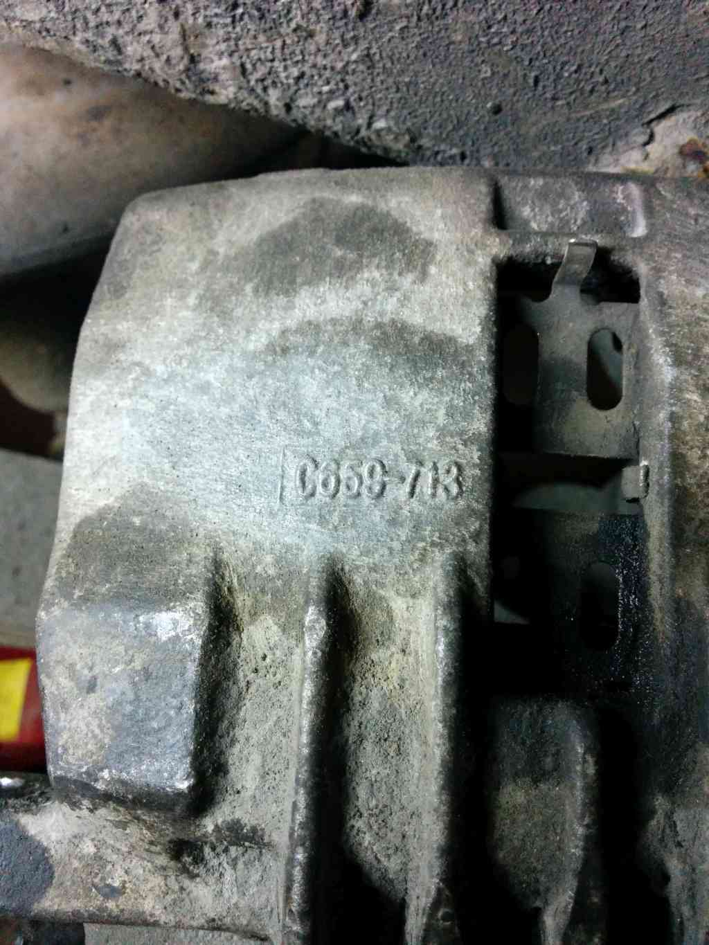

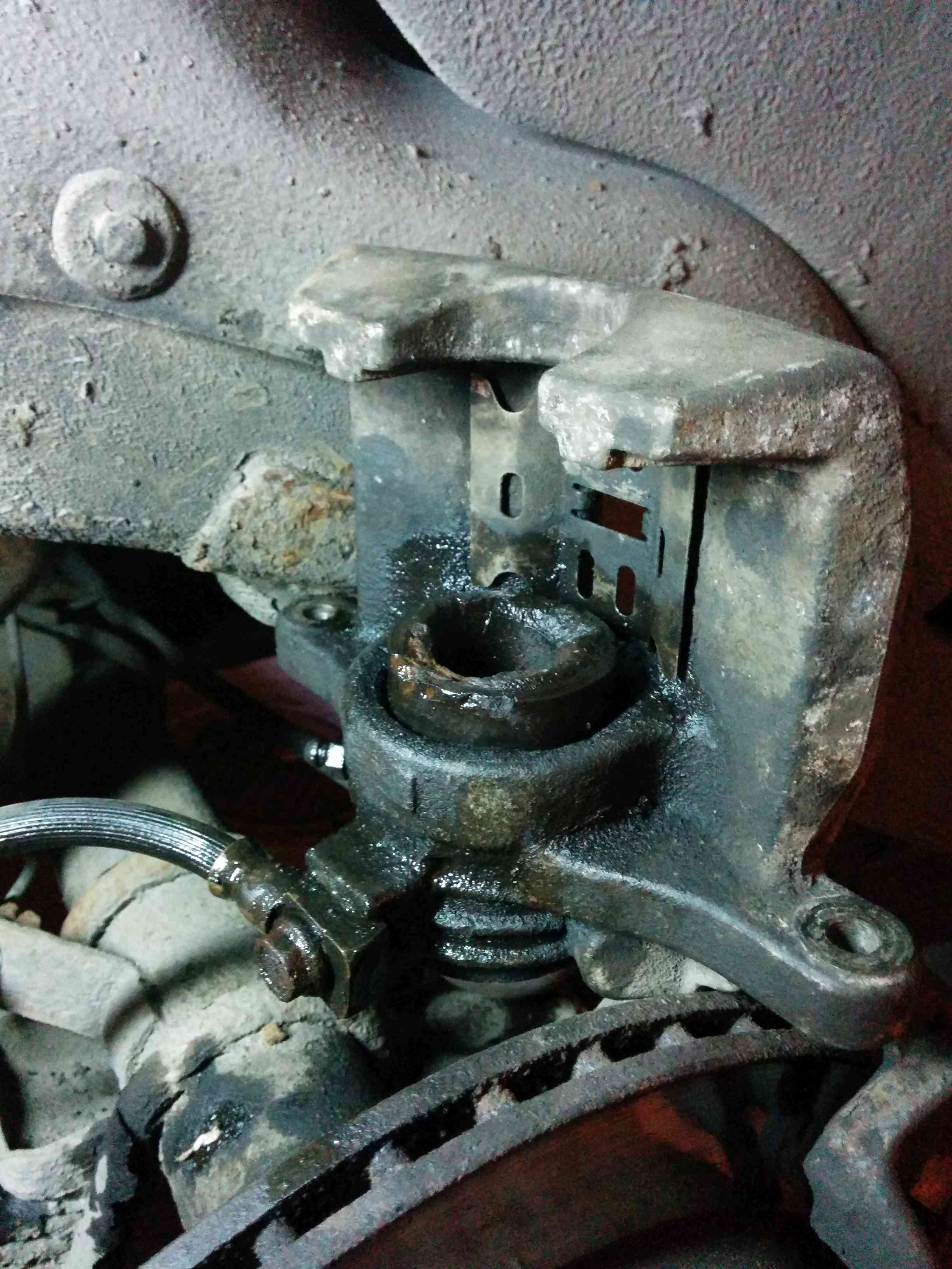

Hello i need an new rear right (or booth) caliper for my 1998 4WD but is not sure which one. WAGNER, ACDELCO or A-1 CARDONE?
can anybody tell from the pictures?

I believe that Blazers with rear disc all use the same caliper for both RWD and 4WD, 2dr or 4 dr.
I see Wagner CR134335, A-1 Cardone 184712, AC Delco 18FR1487 all appear to be the same caliper...at least to me.

The castings all pretty much look the same. The only advice is that an ACDELCO rebuild uses an AC casting (hopefully).

Thanks, its ordered :-)
