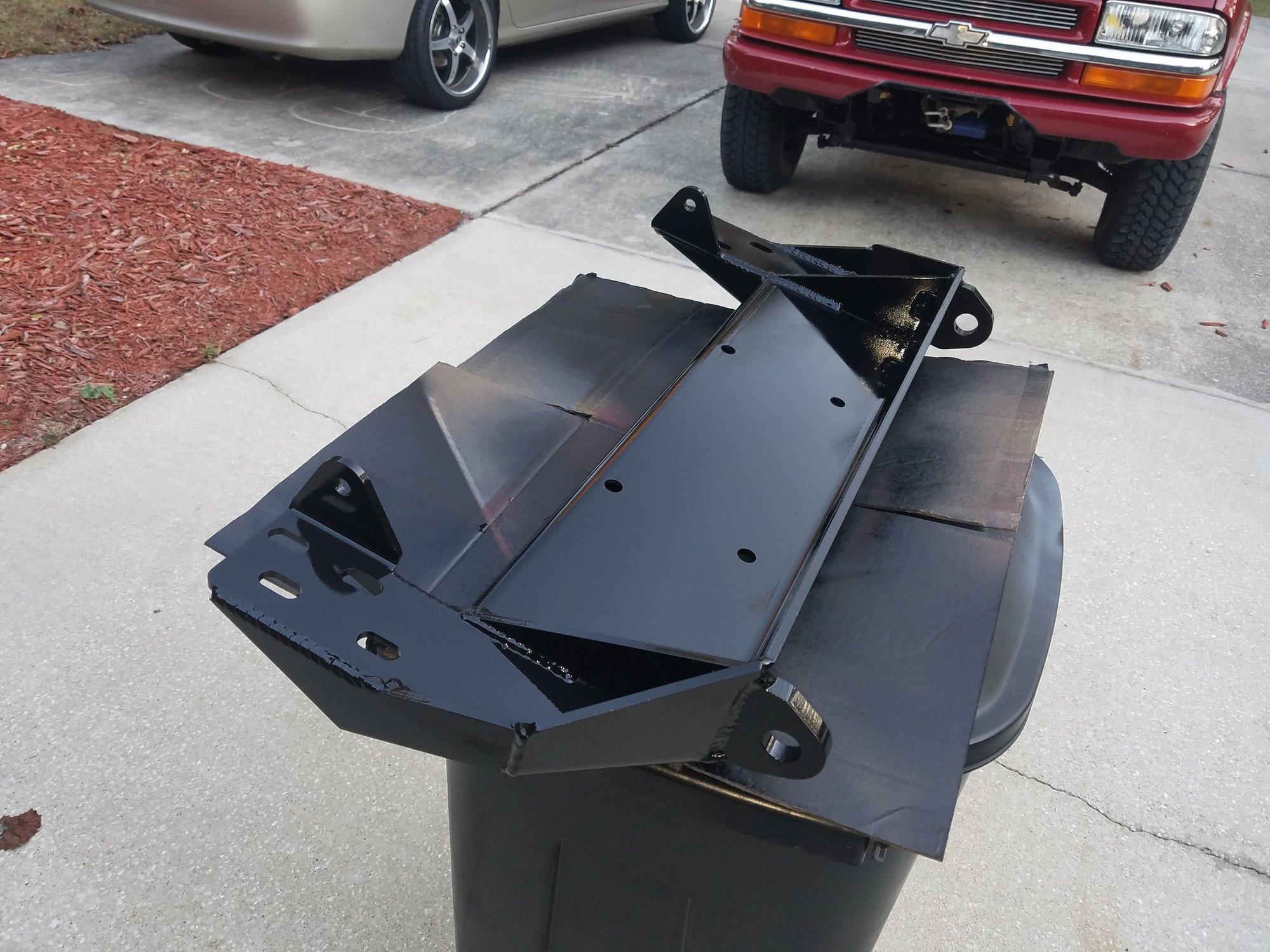

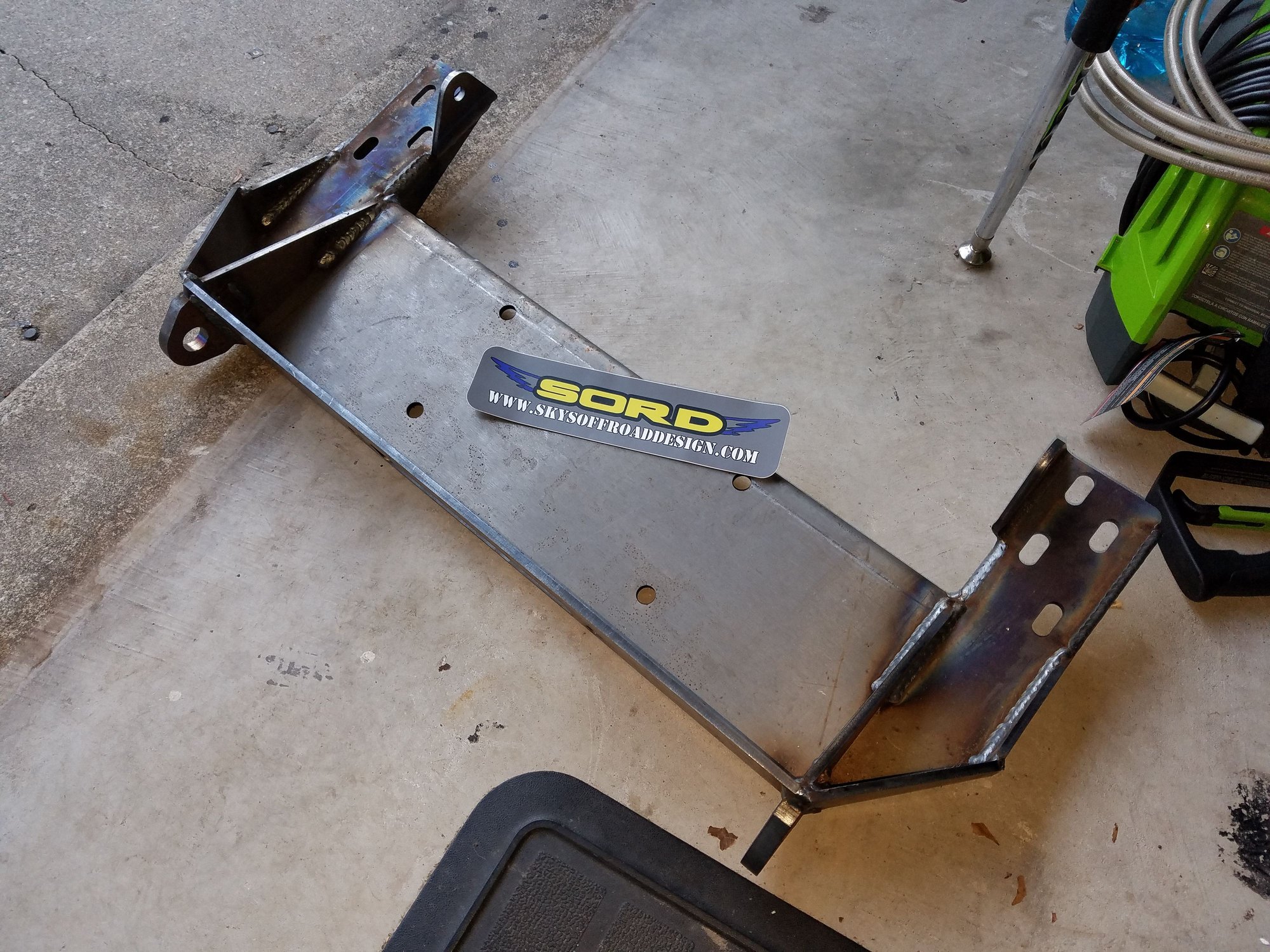

There are a number of places you can get the plate for the "hidden" winch. Bolt right up to the frame horns and shouldn't cost too much.

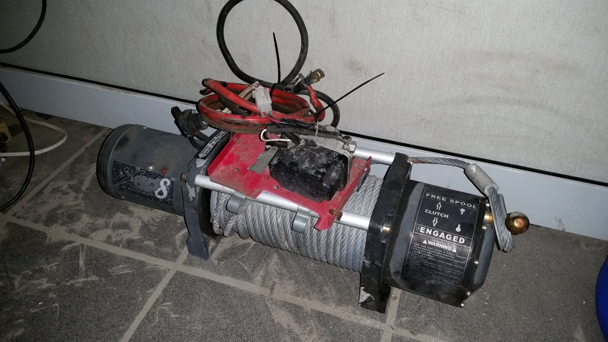

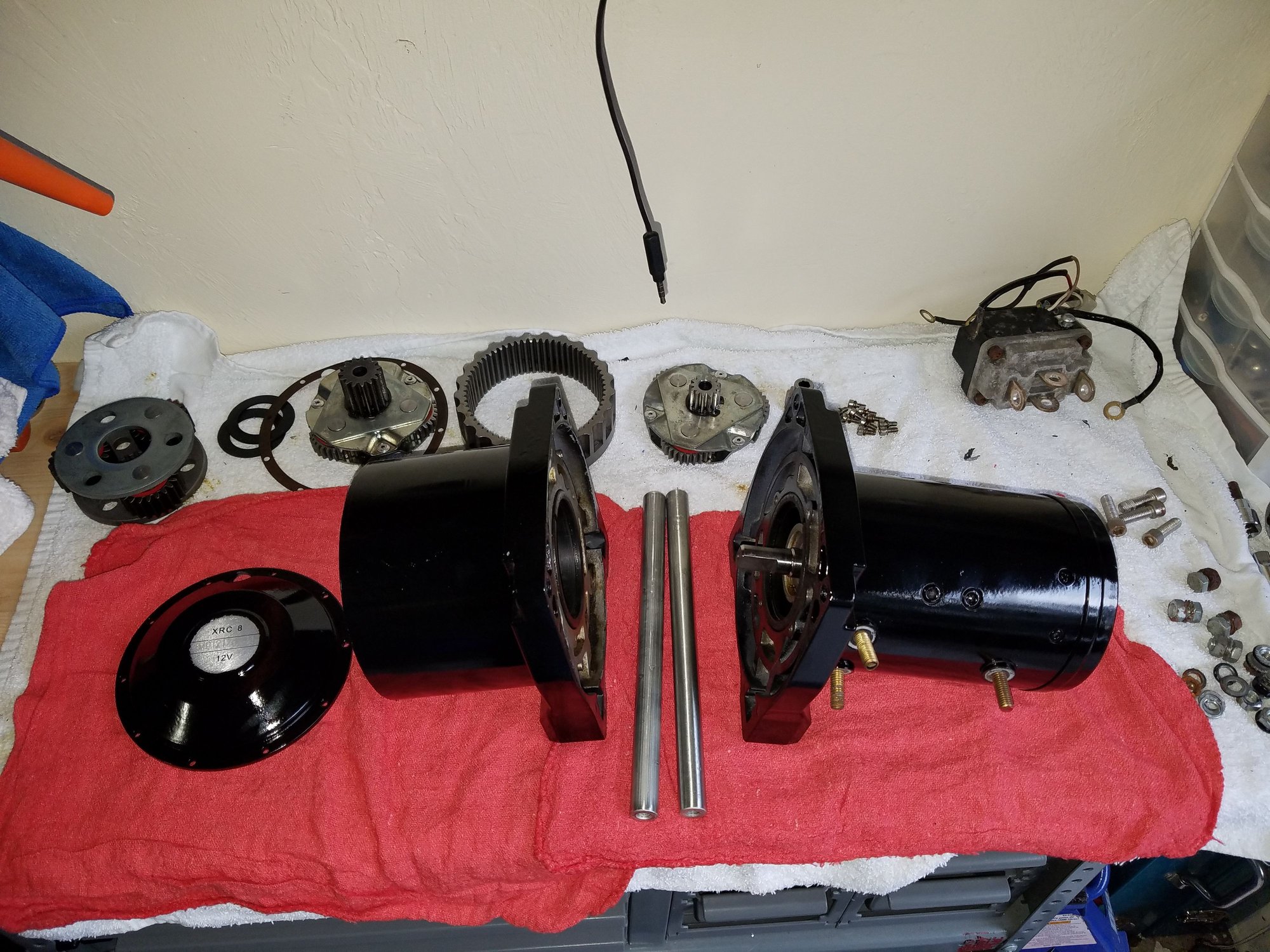

Agreed with the above. You can always check for a used winch locally for a better deal. In my case I got an 8k Smittybilt for dirt cheap, completely blew it apart and rebuilt and repainted it, even put new stickers on it, it looked and operated like a brand new unit when I was done. Because I got my winch used, my mounting plate actually cost me more than the winch did! I made new 2 gauge power cables with some extra car audio cables I had laying around, even wired in a 500 amp isolator so I can disarm the winch when not in use (totally not necessary...). I had to replace the solenoid box in my case but I just bought and wired in a cheap one from eBay for like $20, works like a champ. As far as accessories go, the first thing you want to get is a good pair of thick leather gloves to wear when handing the cable. Not so much of an issue if you have synthetic rope, but if your handling steal wire rope the last thing you want to do is catch a frayed strand in you bare hands... But other accessories can be added as your go. Two others I would recommend are a ****** block and a pair of small slings or tree savers. For safety it's always good to have one of those weighed cable covered things (I forget what they're called exactly...) that you toss over the cable when making a pull, keeps the cable under control in the case of it snapping. You can make do with a thick jacket or a wet towel though. Personally I've never used one, but I have yet to really put a really heavy strain on my winch cable that made me worry about it. My electrical system is beafed up, but it was before my winch install because of audio stuff... But in your use case, and probably as much as I actually use mine too, the stock charging system should be just fine.
Long story short, I think I paid $50 for my winch, $200 for the mounting plate, $20 for new solenoid pack, then maybe another $100 on accessories that I didn't already have. So in my case, less than $400.
