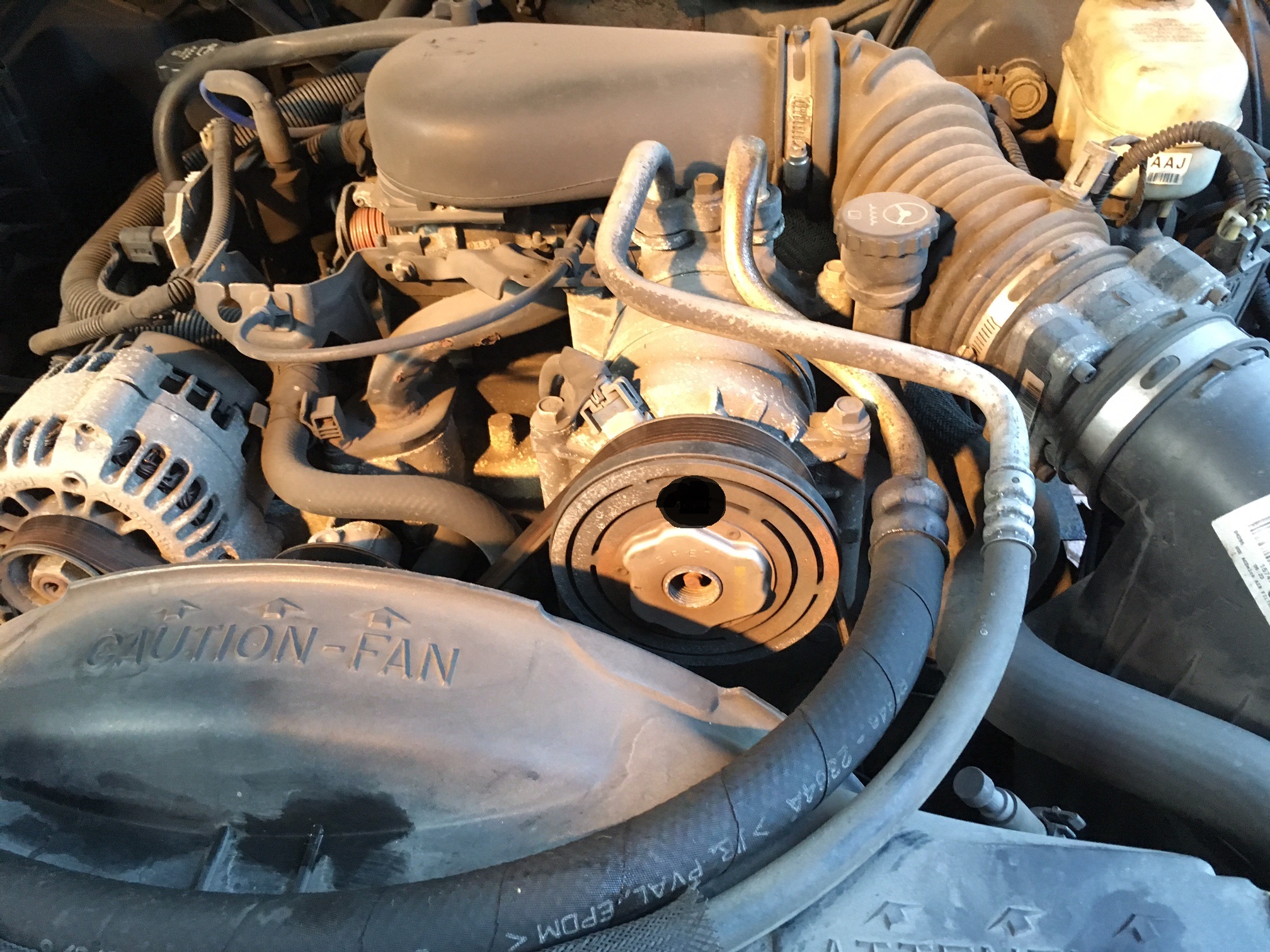

My 2005 Jimmy's A/C works great except at low speeds.
Yesterday I started the engine and turned on the A/C, then looked under the hood to try to identify the problem. At idle, the A/C comes on when the part marked by a large black dot in the attached photo spins; as soon as the part stops spinning the A/C goes off. The face is loose when touched lightly by hand.
Does this mean a new compressor kit is required, or is there an easier fix to make this A/C more reliable?

That is the compressor clutch. When it engages does the compressor turn reliably and what is the center vent temp (get a cheap AC dial thermometer from the parts store)? Is that temp different between idle and cruising speed? It is normal for the clutch to cycle on and off so that does not tell you much.

Yes, the compressor seems to turn reliably when it does turn. I was told by the dealer when the vehicle was nearly new that the rather loud off-on cycling was normal, but given the lack of A/C reliability lately, I was starting to wonder if I had been fed a bunch of bull, and the unit was defective from the beginning and was just wearing out very slowly! But, if that is indeed normal, then that is of no value. Should the clutch feel loose when pressed on slightly or taught?

The clutch is somewhat loose when not engaged. The vent temps will tell us of the refrigerant circuit is in good shape when engaged. If it is but it won't cool the cabin because the clutch does not stay engaged enough then we can go from there. We can jumper the clutch relay and make it stay on continuously for instance.
