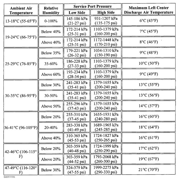

Here is what you vent temps should look like. How long is the cycling on and then off at idle and do your temps meet this chart?
If the cycling is the cause of the problem then there are a number of causes: low, low side pressure (low refrigerant, faulty orifice device, weak compressor valves), high, high pressure (too much refrigerant or restriction), faulty low side switch, faulty high side switch, faulty PCM, faulty clutch, faulty cabin temp sense, .... I can walk you through any of these circuits to test if needed.
Les and others are right though, a set of gauges along with the vent temps will get you the proper info for a diagnosis.
The entire refrigerant circuit has oil circulating throughout so any device that is removed is greasy. As a matter of fact feeling around any connection point for an oily residue helps find leaks.
Again, adding gas might be the solution but there are many other possible causes and more gas can cause problems if not the issue. One of my last failures was a compressor not low charge.

The ambient temperature was 70 degrees at the time of measuring the vent temperatures, not sure of the humidity, but around 40% sounds good. The truck was sitting in the driveway idling when I took the temperatures and the A/C remained on set to Max A/C, it did not cycle off at all.
According to your chart, GeorgeLG, the vents are NOT delivering cold enough air, yet when the A/C is on, it cools quite adequately!

FYI the temps in the chart is for temp of air entering the A/C condenser in front of the radiator. For the pressures and vent temps to be valid, you need to set a fan in front - and temp of this air needs to actually be measured. Also the engine needs to be run at a specific RPM. But I will say that your system seems to be cooling if your air is getting down to 54 degrees.
