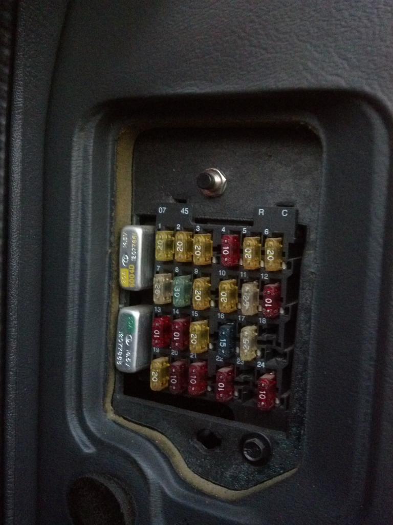

Here is the fuse panel removed...I got a sneaky feeling that silver push in isnt stock either...hmmmm
I dont know for the life of me how I am going to be able to test for a parasitic drain if I cant keep the door open w/o setting off dome lights and door swtich....

The little button is probably the valet button/switch for an alarm of some sort. Your door button looks different that the door button on my 96, mine has a plastic button that sticks out about an inch. There is also a door handle switch that will turn on the interior lights. To the best of my knowledge there is no override button like on the newer blazers on the 96.

Maxboost, do you happen to have a new driver door mirror on that blazer? because that plug in the dash looks like it should be behind the door panel in the access holes for the nuts to the door mirrors. you can drop the panels under the dash and see if you find then button to trigger the dome lights. ALL blazers had them, yours has to be somewhere. they should look something like this.
just the black part, the white part stays behind the dash.
you can also keep the dome lights off by pressing this button.
dome light override button

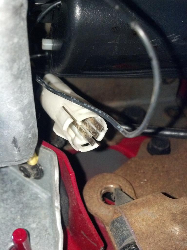

Here is a connector I found up in the dash...there is a couple more, but are rectangular in shape, so doubt those are for the door switch....think this one is it, minus the black plunger part?
Might order another one and see if that helps out my situation at all.......

thats the one! i would imagine that someone pulled the dash at some point and forgot to disconnect that and ended up pulling it out by accident. i have done that before. but that would be the dome light switch, well half of it anyway.
and about the dome light override button, i couldnt remember what year that they changed that over and added that. sorry. but at least you knew what i was talking about. good luck with fixing everything, if you get a new dome light door switch, you should be able to unplug that white piece and just plug in the new one. i think that you have to put it through the dash from the outside and then plug it in from under the dash. they should only be a few buck from the dealer if they even have any. the cheapest one is like $5 at rockauto.com plus shipping. they are under electrical switch and relay under door jamb switch.

Okey dokey...got the new door light switch thingy...dropped dash panel, scraped hand all to hell and installed it. The lights still act as they did prior...I can have the door open and push in the door switch and the dome lights remain on.....I held the damn thing for like three minutes and it never went off.
So again, my question is how in Sam Hell does the light know the door is open....its got me baffled. If I cant get that light out, I can not load test for the parasitic drain.......
Getting stumpped over here..........
