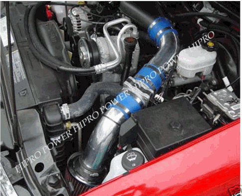

My setup looks exactly like the one shown on the picture. I unhooked the battery terminals for a little while and took it for a test drive( a couple trips of like 15 miles) and is not running bad after all. But this morning when I was driving to work the check engine light came on. Not sure why, anyone has any ideas? Are you supposed to let the computer know of the changes you have made or something???? I haven't scanned the code yet but as soon as I do I will post the results.

Did you put the mass air flow sensor in backwards??? theres arrows on it to make sure ya have it the correct way!!

I checked the mass air flow sensor and I think put it the right way, with the arrow pointing towards the engine. Right?

If you took off the plastic intake that attaches to the throttle plate, did you reattach the breather line that goes from it to the passenger side valve cover?

Hahaha, I don't know if that is the reason but I know for a fact that I did not put that hose back. I remember playing with the intake a long time to get the fittings to fit nicely and completely forgot about it. That should probably fix it. Thanks a lot. I will let you know how it goes.

also, your going to want to replace the cheapo ebay filter ASAP! get a K&N or spectre or somethin, those ebay ones are no good!
