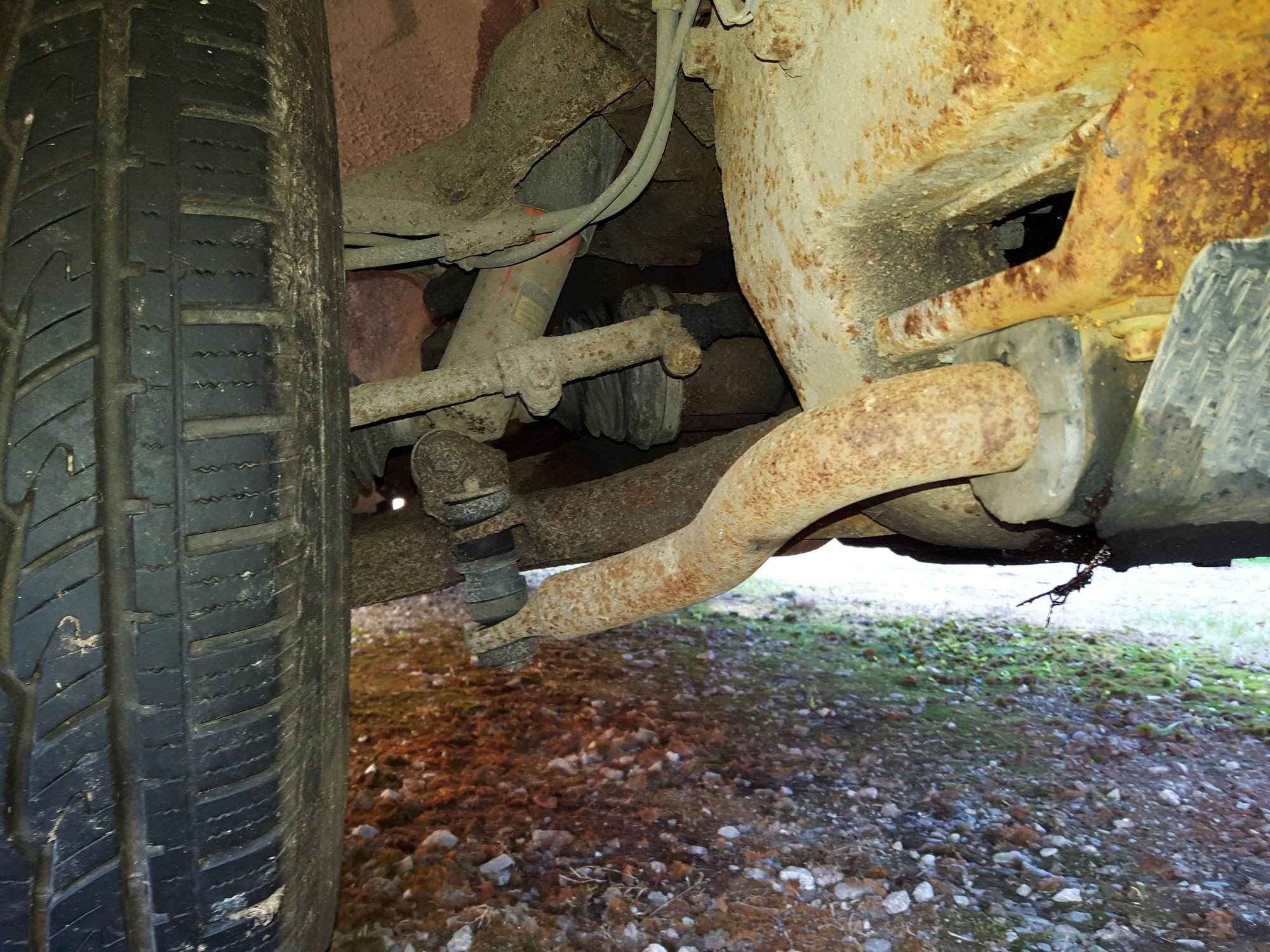

Is this correct?

I'd give up the "bent sway bar" idea. You'd rather rip the mounts off than have it bend.
The Blazers come with at least two different base frames, and I think same applies to the control arms. You should have a same set as blazen_red_4x4, not like me.
Prior You place any order, make sure whether the sway bar is an incorrect type or the control arms. What model actually do You have?

Hi mate,
I have a 2000 Blazer, 4.3 V6, LT right hand drive
Old Sep 30, 2018 | 10:53 PM
Posts: 5,643
What does the attachment on the other side look like?
Old Oct 1, 2018 | 01:14 AM

2WD or 4WD?

Originally Posted by Mike.308
2WD or 4WD?
4WD Mike
exactly the same the other side mate!

Originally Posted by Westy
4WD Mike
This is really confusing... I also have 4WD LT (left hand drive, european edition), same control arms like You, but my sway bar is wider.
With regards to Shaun input, I still have my doubts.
blazen_red_4x4 is from Florida (definitely not right hand drive) and his control arms seems to fit Your sway bar perfectly. I wonder what models he has?
EDIT: Found it: https://blazerforum.com/g/album/7778872 He's got LS not LT. So, for me it looks like Your control arms are ok, but the sway bar is from LS not LT.

Old Oct 1, 2018 | 04:48 AM
BooTs's Avatar
Joined: Dec 2007
Posts: 66
From: Normandy, France
BooTs is on a distinguished road
I've just taken this photo of my 1999 RHD Blazer that I've owned since 2000. Hope this helps. I have same model as you do.
