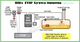

An ODBII system does a self test every drive cycle and sets a code if the system malfunctions. Evap systems vary across makes but this generic picture and description captures the essence of the basic function and faults.
The gas cap is sealed. The purge valve is normally closed. The tank is vented through the charcoal canister and the normally open Evap vent solenoid. This captures fumes temporarily but still allows tank venting for filling and drawing down from the fuel pump. Normal function is to occasionally purge the stored vapors from the charcoal canister into the throttle body by leaving the vent solenoid open and opening the purge solenoid so that the stored vapors are sucked into the throttle body from the vacuum in a controlled manner. Then the purge solenoid closes.
The system is tested routinely by closing the evap solenoid and either applying a vacuum or pressure to the system either through engine vacuum or a dedicated pump then leaving the evap and purge solenoids closed and see how well the system holds a vacuum/pressure. Codes are set if the system is leaking or cant get charged for the test.
The charcoal canister, hoses and vent solenoid can either be cracked and are leaking or are blocked and can't vent to the atmosphere. The most common failure after a leak from cracked hoses or canister is a faulty evap solenoid that either won't closed for the test or is always closed and won't vent. When you cant fill your tank then then air cannot escape from the top of the tank as the fuel level goes up because the vent path of tank/hose/canister/hose vent valve/hose is plugged somewhere and not normally open as it should be.
