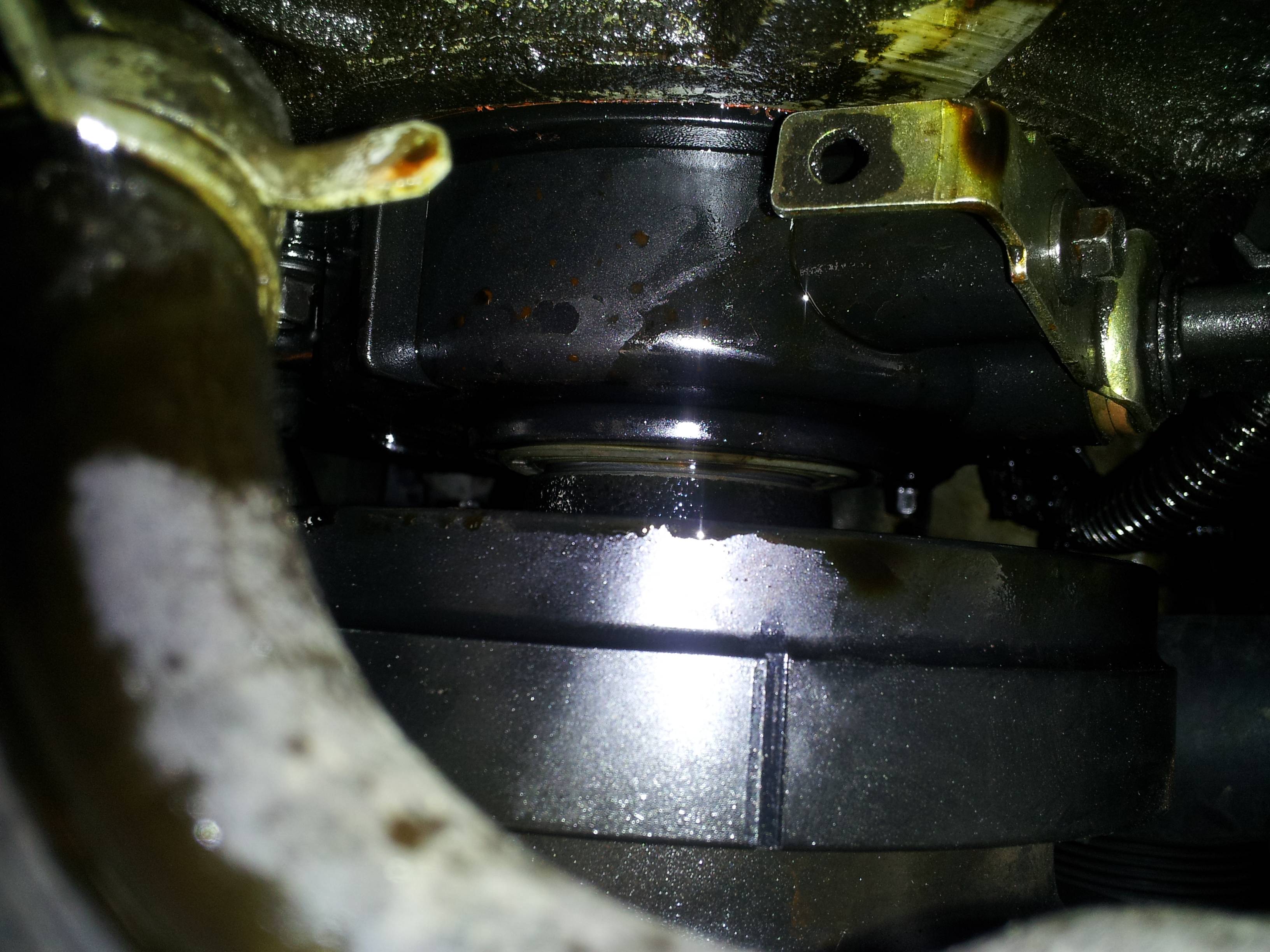

Edit: here in a few minutes I am going to try and upload a picture from my harmonic balancer where it meets the seal. I can see silver from the balancer but I'm not sure if I am supposed to.
Here is that picture.

It's hard to tell what silver you're talking about, but I'd replace the seal for sure- it is less than $10 last time I checked... And if it's leaking now it is almost certainly leaking because it is damaged. Be careful removing and installing the seal bc the chain cover is plastic and replacing the cover is an even bigger job. Check the seal surface of the damper for damage before reinstalling.
