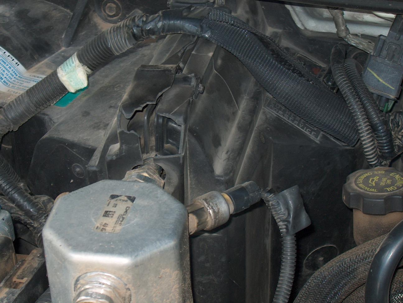

Old May 28, 2012 | 03:48 PM
dano440's Avatar
Joined: May 2011
Posts: 185
From: Kansas
dano440 is on a distinguished road
here is a pic of mine
Old May 28, 2012 | 05:33 PM
step66's Avatar
Joined: Sep 2008
Posts: 733
From: Snow Hill MD
step66 is an unknown quantity at this point
Yeah-common... I have been using donkey -dick to fill the spaces,no need to replace assemblies in 15 year old cars and this stuff is very inexpensive,and easily removable when needed and then easily replaced! No it isn't factory,but it works! Can any one really expect a full factory car after 15 years? Not likely! My best to you! Good luck!
