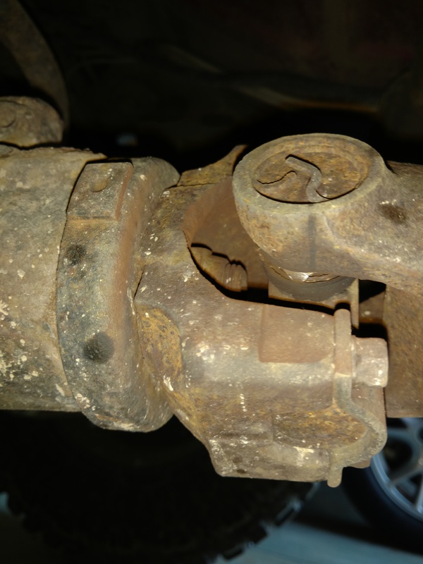

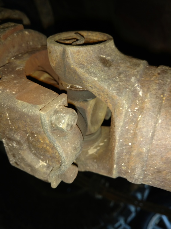

This is what i found yesterday. Looks like one of the caps on the rear u joint lost the rubber seal and is starting to fall apart. Weird thing is there is no play in the driveshaft. Plan on changing the u joint out on thursday.

Sounds good, thanks for the update!
