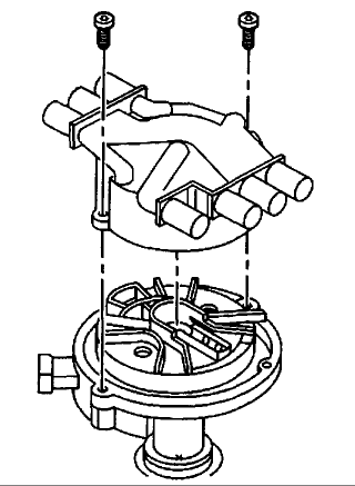

3. Remove the spark plug wires from the distributor cap
o Twist each spark plug 1/2 turn.
o Pull only on the boot in order to remove the wire from the distributor cap.
4. Remove the electrical connector from the base of the distributor.
5. Remove the two screws that hold the distributor cap to the housing.
6. Discard the screws.
7. Remove the distributor cap from the housing.

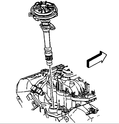

8. Use a grease pencil in order to note the position of the rotor in relation to the distributor housing (1).
9. Mark the distributor housing and the intake manifold with a grease pencil.
10. Remove the mounting clamp hold down bolt.
11. Remove the distributor.
12. As the distributor is being removed from the engine, watch the rotor move in a counter-clockwise direction about 42 degrees . This will appear as slightly more than one clock position.
13. Note the position of the rotor segment.
14. Place a second (2) mark on the base of the distributor. This will aid in achieving proper rotor alignment during the distributor installation.

4. Guide the distributor into the engine.
5. Align the hole in the distributor hold-down base over the mounting hole in the intake manifold.
6. As the distributor is being installed, observe the rotor moving in a clockwise direction about 42 degrees .
7. Once the distributor is completely seated, the rotor segment should be aligned with the mark on the distributor base in location number (1).
o If the rotor segment is not aligned with the number (1) mark, the driven gear teeth and the camshaft have meshed one or more teeth out of alignment.
o In order to correct this condition, remove the distributor and reinstall it.

There are two notches on the crank dampener. If you choose the wrong groove, the engine will be 180* out of time. I have always preferred holding my finger over the #1 spark plug hole while someone turns the crank from underneith. Once your finger gets pushed out by the building pressure under the compression stroke, I look for the mark to come around and line up. I would then note the location of the #1 pin on the inside of the distributor cap. You can't just line it up with the location of the #1 spark plug on the flat layout cap. You have to follow the layout on the top of the cap and mark the distributor body with this location. If you don't know how far the rotor will turn as you drop the distributor down onto the cam gear, you'll have to go by trial and error. You will mostlikely have to rotate the oil pump drive appropriately to line up with the drive end of the distributor.
