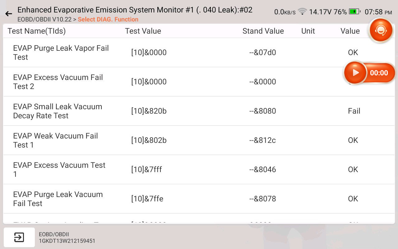

Using the scan tool, I closed the vent solenoid and observed the fuel tank pressure sensor value (I believe it was in H2) change then opened the vent valve to watch the value return to it's starting point. In theory that should show a good system to start.
I then ran the same test and took the gas cap off and No change in value as it did when I turned the vent valve back to venting.
Then I ran the service bay test and it failed the EVAP small leak vacuum decay rate test.
[img alt="Service bay test result
"]https://cimg4.ibsrv.net/gimg/blazerforum.com-vbulletin/1280x800/evap_test1_259aba02cf27776f12096675adf59e3cc624e4d 0.png[/img]
Again the at rest value of the fuel pressure sensor responds to sealed and unsealed commands and no smoke is observed at the lines or fuel pump area.
When I do inject smoke at the test port near the engine, I do not see any smoke to enter the fuel filler neck and if you remove the large line off from the EVAP Canister there is a woosh of stored smoke in the canister. I did remove the canister and it shows no deterioration or signs of being damaged or plugged.
I did replace the gas cap as it is always suspect at over 100,000 miles with a NAPA cap that has the same OE style O-ring. Same test results using old and new cap.
Quick note: I did have my truck in the shop in March for a Lean code bank 1&2 and the faulty Purge solenoid was replaced.

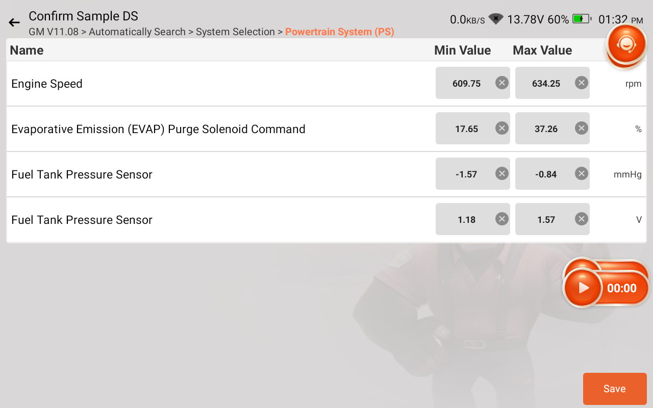

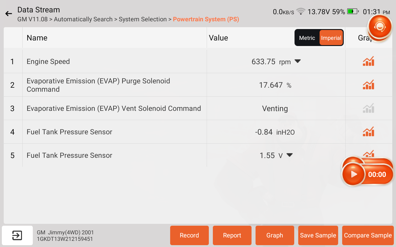

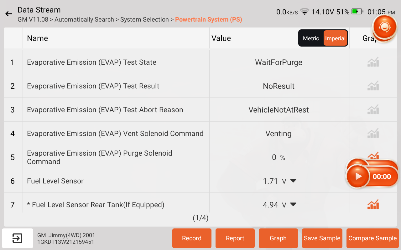

Good call... EVERYTHING you quoted is Spot On and we are on the same page. All values confirm with the truck running, working as designed.
I did check with the engine running the same test for vent solenoid actuation on/off and commanded the vent closed at idle, watched the pressure value change, took off the gas cap to watch the pressure value change back to vent ,heard the air rush in, and value went back to original reading.
Sorry to not have the readings as I am still learning the retrieval in my new scanner.
Here is what I have so far:
EVAP Values
EVAP readings at idle.
EVAP service bay test.
