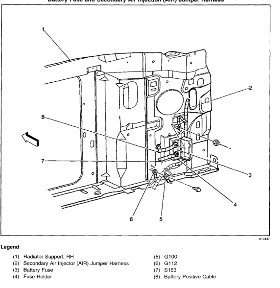

Ok, think I found my G100 ground. ALDATA shows:
G100
G100 (W/ California Emissions)
G100 View
G100 View
#5 & #6 are grounds
One with a Location View, typical that mine is a California emission, still should be in the same location.
Truck is from Western NY, but still has some rust. Just not ready to get anything newer.
