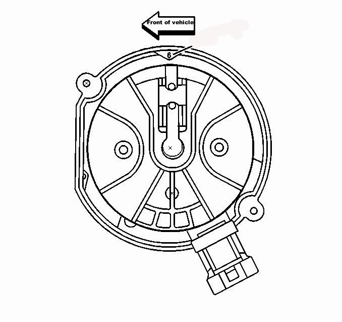

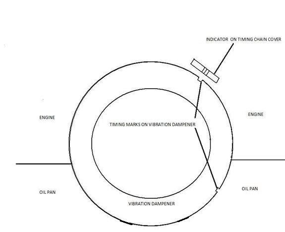

If the engine starts & runs, it's probably off by only one tooth.
Using a socket & ratchet on the crankshaft center bolt, manually rotate the crankshaft clockwise until the marks are aligned like the first image below, AND the distributor rotor is within a few degrees of the "6" in the second image. Keep in mind the crankshaft makes two revolutions for each one revolution of the distributor rotor. This means when the crank marks are aligned, the distributor rotor could be near the "6", or 180 degrees opposite. So make sure it is within a few degrees of the "6".

When turning the crankshaft, turn it clockwise ONLY. Once both are aligned correctly, remove the distributor and reinstall it so the rotor points to the "6" when the distributor is fully seated against the intake manifold. You might need to rotate the oil pump drive shaft if the distributor will not fully seat.

If you are still getting a P1345, then probably it's not in right. Is your SES light on when running? Have you cleared codes and the P1345 set again? Roll the engine over to TDC again now that the engine has run and recheck that the rotor is still pointing at the stamped "6" in the distributor housing.
Timing is determined by the crank sensor and PCM, not by the distributor. Function of distributor in these Blazers is only to distribute the spark to the right spark plug, and to provide a signal to the PCM (cam sensor) that tells it which cylinder is supposed to be firing for the purpose of timing sequential fuel injection pulses. To do this the rotor has to be pointing exactly at the expected terminal and the PCM evaluates this by comparing the relationship of the cam sensor signal to the crank sensor signal. If the cam retard value (relationship of cam sensor) is off over 23° or so (I think ideal spec is ±2.0°), it knows distributor is in at least 1 tooth off and it sets the P1345.
Even if your timing chain was off 1 tooth, you should still be able to drop the distributor in so the P1345 does not happen. I really doubt if timing gears being off is the problem. But if the distributor had never been out or turned, you are correct that getting the timing gears off would also throw off the cam signal.

If you paint both of the harmonic balancer marks with yellow or white, then it becomes quite easy to see alignment with the timing cover (use a flashlight). I just dropped my own distibutor in last night. Yes, agree it can be a pain to turn the engine with a ratchet to get that mark lined up exactly with the timing cover but it is important. I used a 3/8 drive torque wrench spun up to 65 ft/lbs (is longer than a ratchet for more leverage) with a 1" extension and a deep Snap-on 5/8" 6-point socket on the harmonic balancer bolt. Worked best with left hand holding torque wrench handle (pulling up), and right hand holding socket in place while looking down beside the A/C compressor at the marks. Wife holds flash light.
