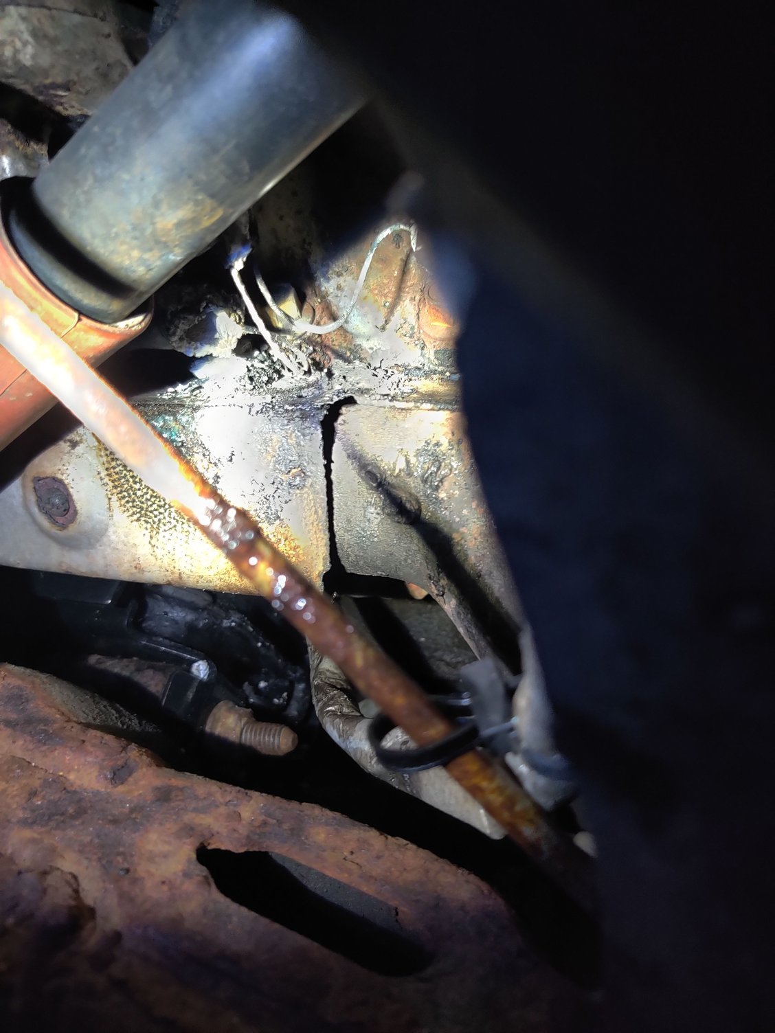

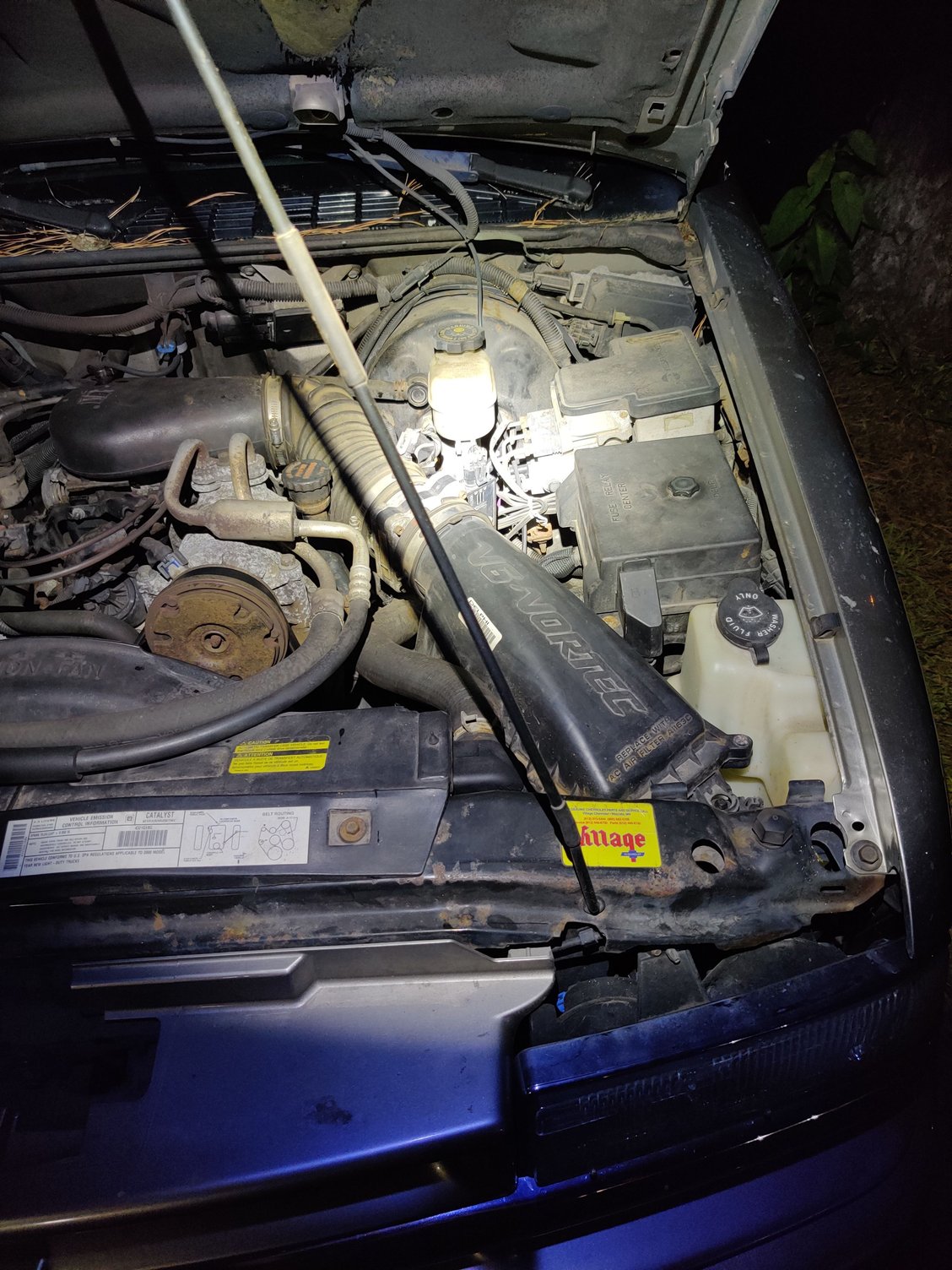

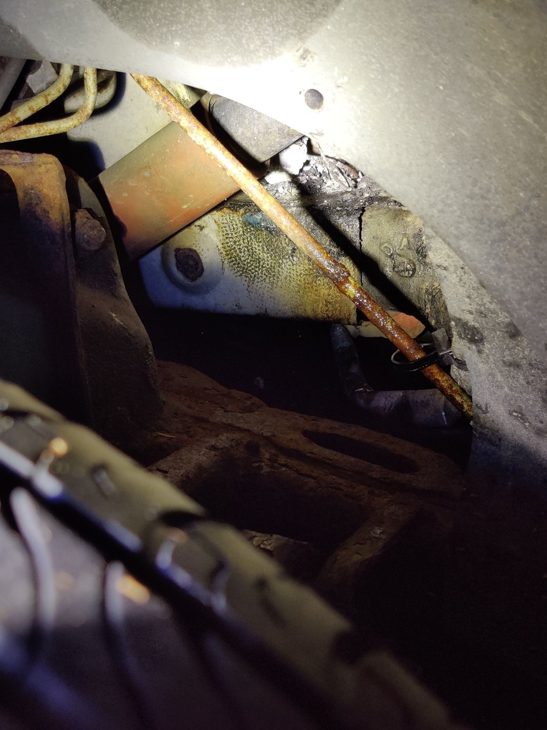

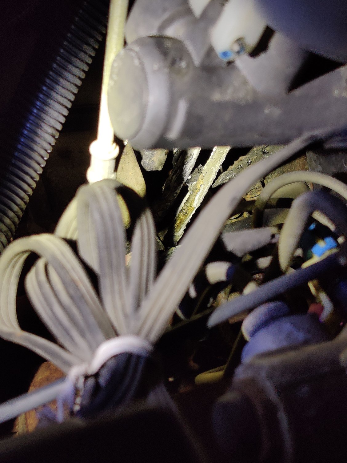

Old Jul 27, 2020 | 09:43 PM
Lev's Avatar
Lev
Joined: Feb 2020
Posts: 5
Lev is on a distinguished road
Happened under where the flashlight is pointing
Looking straight down from where the flashlight was, those two hoses
Looking through the left wheel well
Old Jul 27, 2020 | 09:48 PM
Looks totally unrelated to the 4x4 being engaged. There's nothing in those pictures that is related to the 4x4 system. Sounds like it was just a coincidence that it happened when you put it in 4wd.
By the looks of it, your spark plug wires leaned against the exhaust manifold and melted and caught ablaze... I'm assuming the truck started running like garbage at this point, like it was about to stall? Because it looks like you would have lost spark on at least 2 cylinders.
It looks like the bracket that holds the plug wires is missing in your photos, so that would explain how they managed to come into contact with the manifold.
Old Jul 28, 2020 | 03:39 PM
if you look here, looks like it melted to bare wires...
