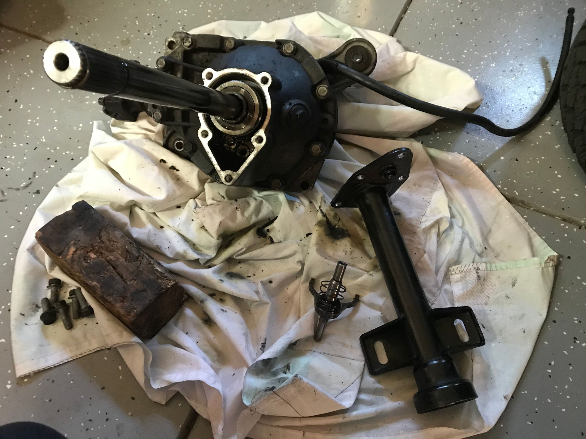

I spent some time on the front diff getting the axle seals out; WOW!...the left side was in there. I actually took the seal "bracket" off as I did not want to risk any damage to the bearing. I had to BEAT! on that seal to get it out. I was afraid I was going to bend the "bracket", but did not. The right side is in the tube, so I took the tube off the case. No way to drive it out from the inside, so I used my trusty crowbar and levered it out. Actually came out a lot easier than the left side.
I did this as I wanted to check the condition of that sliding collar that locks in the right side wheel. All looks good. Now I need to find a sealant to use to re-seal the plate and mounting bolts. Whatever was used is quite hard, not flexible at all, almost like an epoxy. Will have to search around and see what others have used.

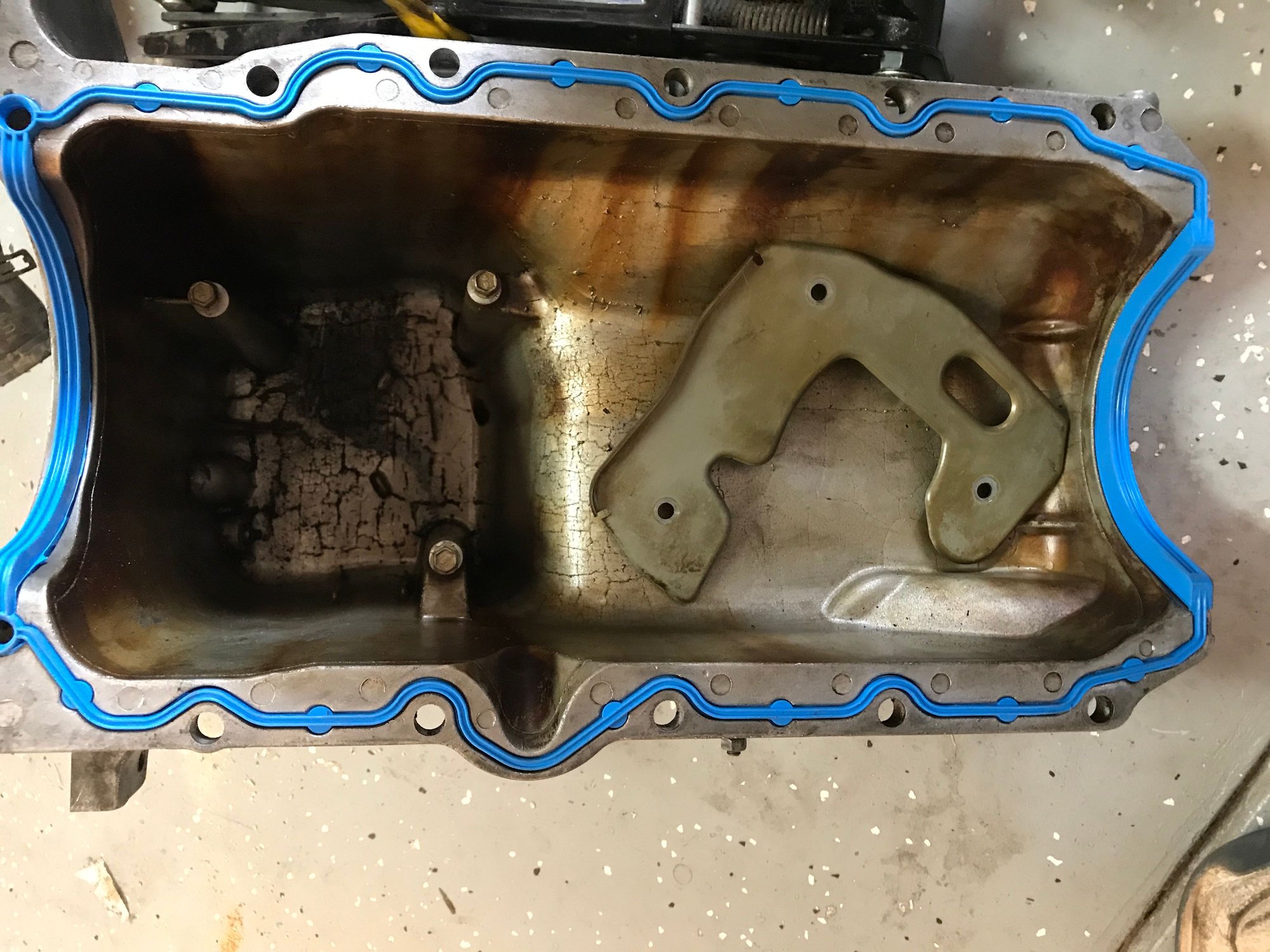

Oil pan with the oil splash removed and new gasket in place.

The front diff right side tube off, shows the sliding collar and fork. Just going to clean-off all the oil/grim, replace the inner seals, then re-assemble.
