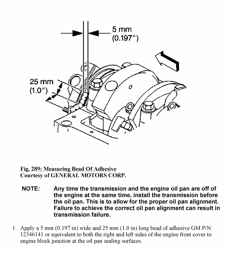

Where did you apply RTV at?
While the FSM says to do it like this Its probably best to just run the bead all the way down, no harm in doing so just control the amount so it does not press out into the block.

I do not have the FSM for reference; I applied RTV to the four corners of the oil pan and around the two holes at the rear where those two studs are at; looks like I should have applied more according to the FSM.
Looks like I will be dropping the front diff (again) to inject some RTV.

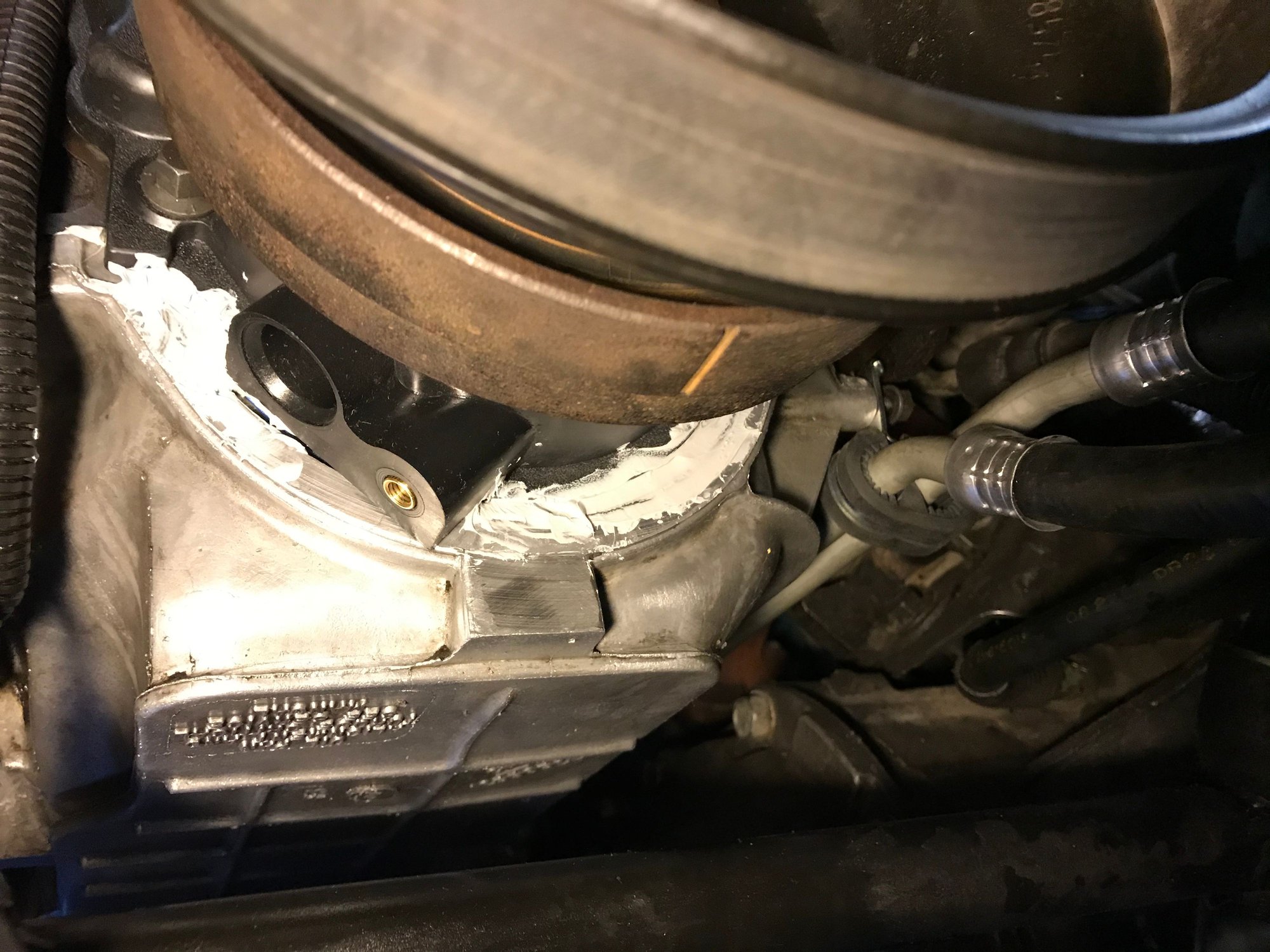

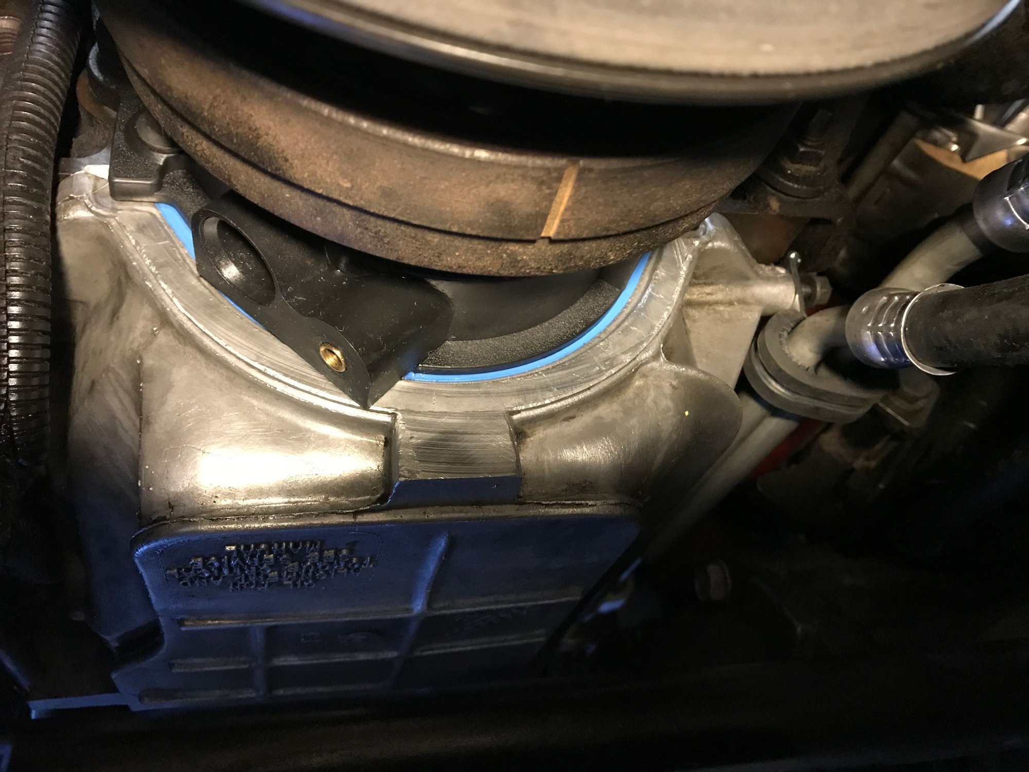

Decided to go with the "bandaid" at this time.....really nothing to lose.
Tightened the left side front oil pan bolt a bit more, cleaned area, cleaned area, cleaned area. Applied RTV........will give it a try tomorrow.
BEFORE.....
AFTER....

Got a No-Go....after I tightened the left front bolt a bit more, then applied the RTV as shown above...the leak got worse. Coming from behind the crank sensor hole in the timing cover....of course not able to see behind it.
So I get to do most of this all over again, this time hopefully as originally planned....drop, not remove the differential. Will see how it goes. Hey Mod....will be able to answer your question in a few days.
