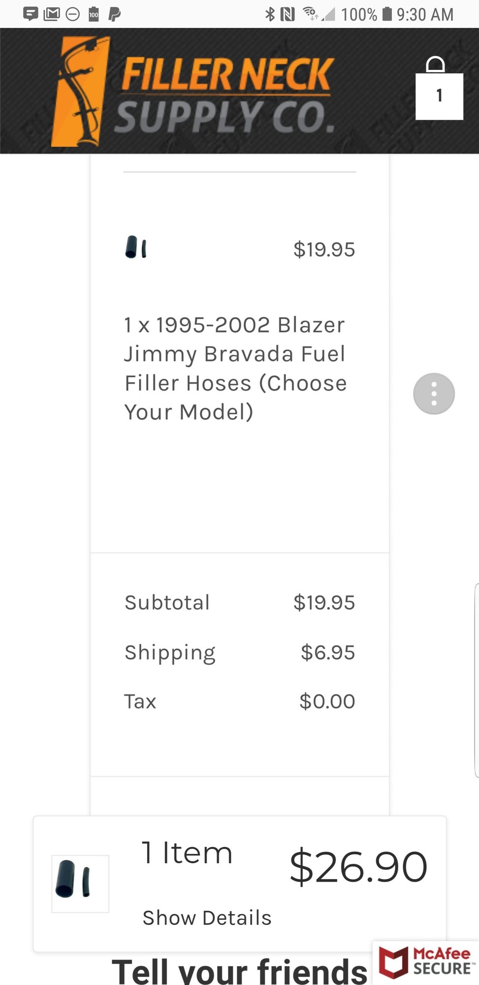

So this reminded me that someone posted some information on this. I've since found it and saved a pdf of the thread for my future reference.
Here's the thread: https://blazerforum.com/forum/2nd-ge...-source-95490/
And here is a vendor you might find useful: https://www.fillernecksupply.com/sea...ection=product
Hope this helps and Thanks to LannyL81 for the original post!

Got it! Unfortunately I'm gonna have to make do with pieces of radiator hose until the real deal gets here. Thanks!!

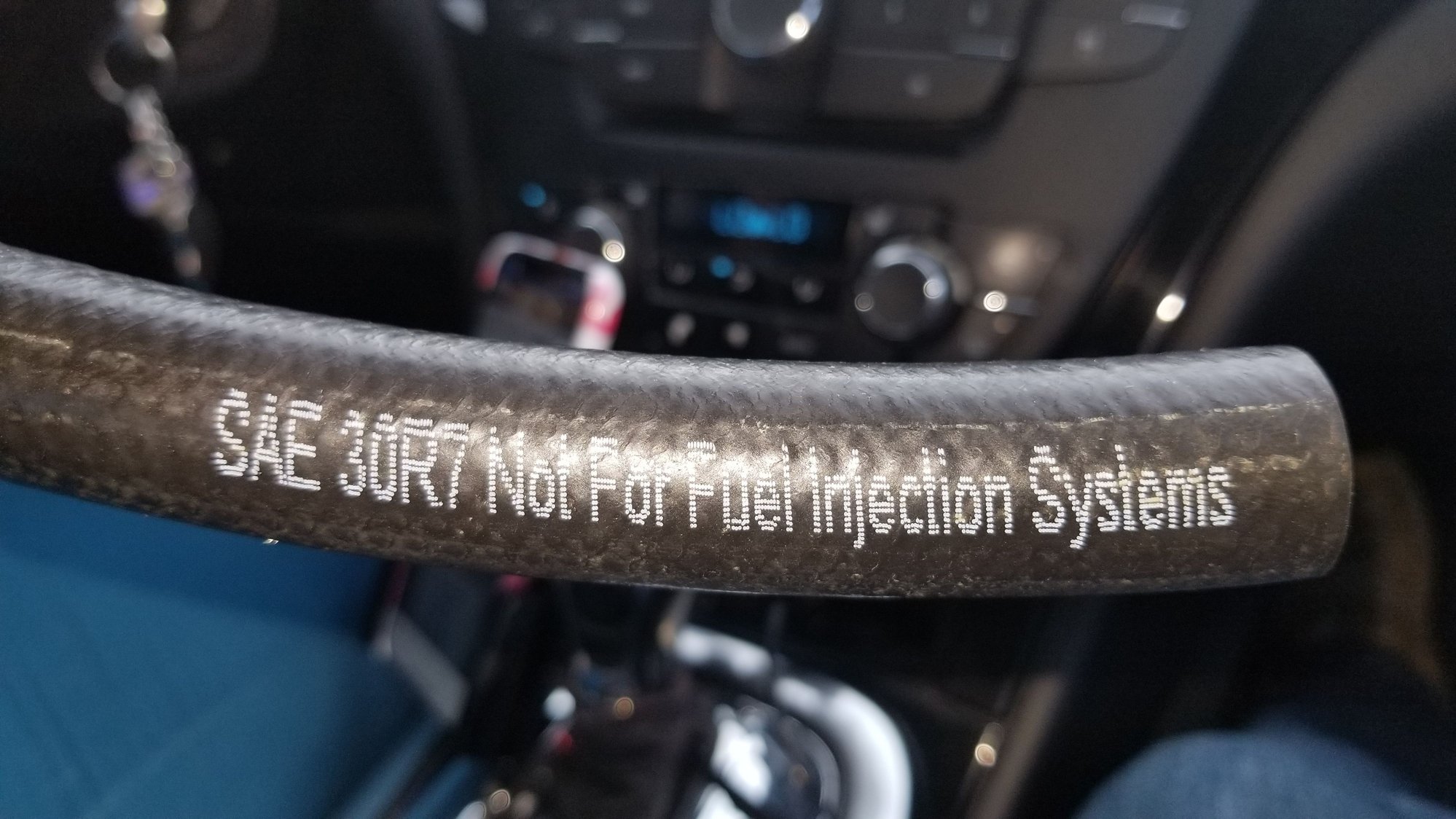

The pieces got here today.
Will be installing them Sunday even if there are hurricanes and sharknados.
Here is the small one. Apparently SAE 30R7 is the type of rubber you use with fuel delivery. I could have probably gotten these pieces cheaper elsewhere
if I had known that.
